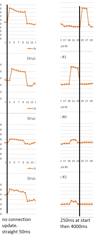

//Edit:
image description
The measurements on the left come in fine.. the 1*interval delay (2nd from top) can happen..
But on the right the 4times connection interval doesn't make sense to me. at least I can't explain it..
4s timer on peripherals does: Measurement + sd_ble_gatts_hvx();
4s timer on central ouputs the values received by
	case BLE_GATTC_EVT_HVX:
	for (int i=0; i<8; i++) {
	empf_buffer[i] = p_ble_evt->evt.gattc_evt.params.hvx.data[i];
	modul_nr = empf_buffer[7];
	zaehler[modul_nr] = 0;
	druck[modul_nr] = empf_buffer[0]<<16 | empf_buffer[1]<<8 | empf_buffer[2];
	temperatur[modul_nr] = empf_buffer[3]<<16 | empf_buffer[4]<<8 | empf_buffer[5];
	spannung[modul_nr] = empf_buffer[6];
so no buffering of data.. or does sd_ble_gatts_hvx(); a sort of buffering?
