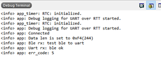

I'm using example ble_app_uart with minor modified. Only add more log to debug.
Hardware nrf52840 DK. Latest SDK v17.0.2, s140.
Connect to mobile phone using nrf connect app.
nrf Connect can connect and send data to nrf52840 DK.
But from nrf52840 DK can't send back to the app.
Got error code: 5 which is NRF_ERROR_NOT_FOUND
Can refer pictures below:

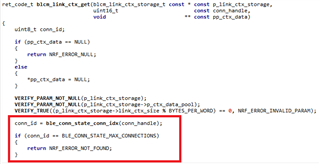

I debug further:
my m_conn_handle = 0x0000 , start from the connection.
during call:
err_code = ble_nus_data_send(&m_nus, data_array, &length, m_conn_handle); ->
err_code = blcm_link_ctx_get(p_nus->p_link_ctx_storage, conn_handle, (void *) &p_client);
it said:
conn_id = BLE_CONN_STATE_MAX_CONNECTIONS
Please help how to solve this.
