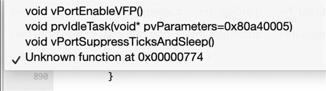

Unknown function at <address> starts executing during the ISR's execution</address>
So...I have an idle task running then a UART interrupt fires upon a character being sent over the serial, and somewhere during the execution of the ISR, it attempts to execute an "unknown" function as shown in the call stack here

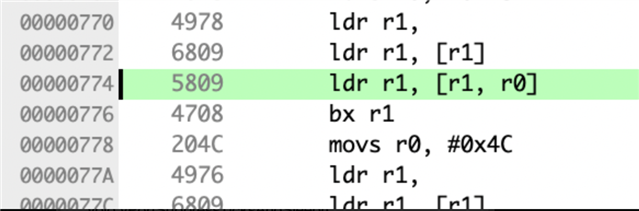

And here's the corresponding ASM code which I have no idea about cause I can't trace it.
Pressing the execute debugger button still executes the same function 0x774. Is it in sleep mode?
    This is within the MBR. The MBR forwards interrupts to the SoftDevice, which forwards them to your application. I am not sure what you mean by sleep mode? (If the CPU is executing code, it is not in sleep at that instant).

    What is the start address of your application? If it is at 0x0, then you are not using MBR or SoftDevice. If it is higher than that, you are typically using the SoftDevice (even if it is not enabled, it will forward interrupts to your application). If you let me know which example project you have based your app on I can check for you. To be frank I think you need to read up a bit on the overall architecture before digging into such details as it seems to me you may be missing the over all understanding that should be in place first.
    Update: I see i referred to 0x744 instead of 0x774 and that typo stuck in this thread. However, both are within the interrupt forwarding code of the MBR, so that is certainly what is going on.

    morpho said:
    I'm building stuff on top of ble_app_hrs_freertos
    That project uses the SoftDevice, and thus MBR. Then we can conclude that 0x774 is from the interrupt forwarding code in the MBR, so all seems good.

    I was referring to the start address of the application in flash as a simple way to know if you use a SoftDevice. If you application starts at 0x0, you do not. If it starts at 0x1000 you are probably using the MBR only. If it start at something higher than that you are probably using a SoftDevice (which includes the MBR).
    morpho said:
    Is 0x774 the SVC number?
    No, it is within the interrupt forwarding table. It seems to be for UART0/UARTE0 (UART0_UARTE0_IRQHandler), which is enabled by default in the example project for UART logging.
