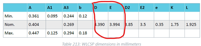

Hi Sir,
There is no tolerance in the D/E dimension of nRF5340, could you help offer it?
# datasheet v1.1, page 792
Thank you
BRs, Han

Hi Hanyu,
The tolerance for the WLCSP of the nRF5340 is 0.03 mm.
-Amanda H.
