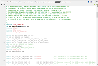

In usbd_ble_uart project, the BLE NUS service instance is defined as BLE_NUS_DEF(m_nus, NRF_SDH_BLE_TOTAL_LINK_COUNT);  In ble_app_nus_c project, the BLE NUS client instances is defined as BLE_NUS_C_ARRAY_DEF(m_ble_nus_c, NRF_SDH_BLE_CENTRAL_LINK_COUNT); Can these two instances be defined in one project? I added both ble_nus.c and ble_nus_c.c to the project. But seem that all the codes in ble_nus.c is not actived in compiling even I have enable the BLE_NUS service in sdk_config.h.

    I assume you are trying to build a central ? Why are you hving ble_nus.c instead of ble_nus_c.c ? It should be the client on the central, not the server.
    So BLE_NUS_C_ENABLED should be = 1 in sdk_config.h
    If you don't plan to have the server on the central, please remove the ble_nus.c
