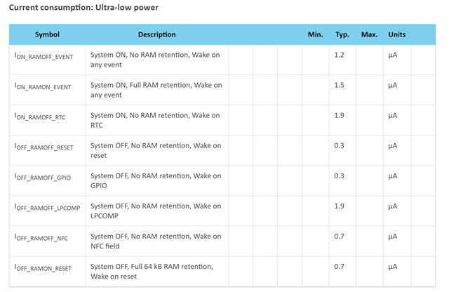

I have power consumption issue about nRF52832 BLE application.
I found "Current consumption:Ultra-low power" informations in "nRF52832 Product Specification" as below
then I use "sd_power_sleep_off" enter system off mode after BLE stop advertisting.
But I cannot get uA current consumption.I have about 1mA current consumption,I don't know what's happened???

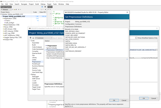

    This sounds very much like your device is in debug mode. Emulated system OFF, which will run in debug mode, will not give the expected result in terms of power consumption. If you make sure that DEBUG is not set in your preprocessor definitions, and you power cycle your device, it should go out of debug mode.

  • Depending on what IDE you're using for development this may vary, but in SEGGER Embedded Studios you will have to remove the DEBUG define from the preprocessor definitions. See the picture below for reference. Please note that you need to make sure that the Common configuration should be used, so make sure that it is.
    After this is done, build and run the application onto your device and power cycle your device (remove all power sources to make sure that it is properly off) before restarting it yet again.
    Simon
  • Hi Simonr,
    I follow your setting as below
    But my device current consumption is same about 1mA.
    I use blinky example(examples\peripheral\blinky\) testing system off mode.
    Because I think this code is clean code.
    My code as below
