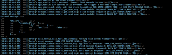

  • Thank you very much for your answer. Unfortunately I have problems how to set the real time configurations inaws-IoT. Can I just edit the shadow and the configurations will be applied? Or how does that work exactly?
    thanks in advance
  • Unfortunately i don't know where i can find out the version of the asset tracker V2. But I use the version which is included in nRF SDK v1.5.0 Toolchain Manager which I downloaded on 12.04.2021.
  • That should be version 1.5.0 as well.
    There have been quite a few changes since then, and we are about to release version 1.6 of nRF Connect SDK. You could have a look at that: https://github.com/nrfconnect/sdk-nrf/milestone/14
    What would be interesting is too see the device logs from a device which is running in active mode, and where you then switch to passive mode on the cloud.
  • 2021-06-17T13:15:19.031Z DEBUG modem << [00:00:00.244,689] [0m<inf> event_manager: APP_EVT_START[0m
    2021-06-17T13:15:19.072Z DEBUG modem << [00:00:00.270,751] [0m<inf> event_manager: DATA_EVT_CONFIG_INITle timer: 120 seconds interval[0m
    2021-06-17T13:15:20.597Z DEBUG modem << [00:00:00.352,905] [0m<inf> event_manager: MODEM_EVT_LTE_CONNEC[00:00:01.803,344] [0m<inf> event_manager: MODEM_EVT_LTE_DISCONT_LTE_CELL_UPDATE[0m
    2021-06-17T13:15:22.430Z DEBUG modem << [00:00:03.613,220] [0m<inf> event_manager: MODEM_EVT_LTE_CONNECTED[0m
    2021-06-17T13:15:22.435Z DEBUG modem << [00:00:03.619,720] [0m<inf> event_manager: MODEM_EVT_L Cloud connection establishment in progress[0m
    2021-06-17T13:15:29.363Z DEBUG modem << [00:00:03.634,3nds if not successful[0m
    2021-06-17T13:15:29.546Z DEBUG modem << [00:00:03.643,676] [0m<inf> event_ma[00:00:10.577,056] [0m<inf> event_manager: CLOUD_EVT_CONNECTED[00:00:10.748,535] [0m<inf> event_manager: DATA_EVT_DATE_TIME_OBTAINED[0m
    2021-06-17T13:15:29.552Z DEBUG modem << [00:00:10.755,493] [0m<inf> event_manager: APP_EVTTAT)[0m
    2021-06-17T13:15:29.553Z DEBUG modem << TAT)[0m
    2021-06-17T13:15:29.566Z DEBUG modem << [00:00:10.773,895] [0m<inf> event_manager: GPS_EVT_ACTIVE[0m
    2021-06-17T13:15:29.577Z DEBUG modem << [00:00:10.789,794] [0m<inf> event_manager: SENSOR_EVT_ENVIRONMENTAL_DATA_READY[0m
    2021-06-17T13:15:29.699Z DEBUG modem << [00:00:10.828,186] [0m<inf> event_manager: MODEM_EVT_MODEM_STAT[00:00:10.870,208] [0m<inf> event_manager: MODEM_EVT_MODEM_DYNA[00:00:10.912,231] [0m<inf> event_manager: MODEM_EVT_BATTERY_DATA_READY[0m
    2021-06-17T13:16:33.775Z DEBUG modem << [00:01:14.979,949] [0m<inf> event_manager: GPS_EVT_TIMEOUT[0m
    2021-06-17T13:16:33.781Z DEBUG modem << m
    2021-06-17T13:16:33.832Z DEBUG modem << [00:01:14.991,607] [0m<inf> event_manager: DATA_EVT_DATA_REA[00:01:15.007,019] [0m<inf> event_manager: DATA_EVT_DATA_SEND[[00:01:15.048,919] [0m<inf> event_manager: CLOUD_EVT_DATA_ACK[
    here I have changed the shadow
    2021-06-17T13:17:19.083Z DEBUG modem << [00:02:00.290,740] [0m<inf> event_manager: APP_EVT_DATA_GET_ALL[0m
    2021-06-17T13:17:19.144Z DEBUG modem << [00:02:00.297,119] [0m<inf> event_manager: APP_EVT_DATA_G[00:02:00.363,159] [0m<inf> event_manager: GPS_EVT_ACTIVE[0m
    2021-06-17T13:17:19.199Z DEBUG modem << [00:02:00.373,260] [0m<inf> event_manager: SENSOR_EVT_ENVIRONME[00:02:00.392,944] [0m<inf> event_manager: MODEM_EVT_MODEM_DYNA[00:02:00.415,863] [0m<inf> event_manager: MODEM_EVT_BATTERY_DATA_READY[0m
    2021-06-17T13:18:23.170Z DEBUG modem << [00:03:04.378,784] [0m<inf> event_manager: GPS_EVT_TIMEOUT[0m
    2021-06-17T13:18:23.189Z DEBUG modem << m
    2021-06-17T13:18:23.191Z DEBUG modem << [00:03:04.390,472] [0m<inf> event_manager: DATA_EVT_DATA_REAm
    2021-06-17T13:18:23.223Z DEBUG modem << [00:03:04.390,472] [0m<inf> event_manager: DATA_EVT_DATA_REA[00:03:04.402,221] [0m<inf> event_manager: DATA_EVT_DATA_SEND[[00:03:04.444,061] [0m<inf> event_manager: CLOUD_EVT_DATA_ACK[0m
    2021-06-17T13:19:19.078Z DEBUG modem << [00:04:00.290,740] [0m<inf> event_manager: APP_EVT_DATA_GET_ALLET - Requested data types (MOD_DYN, BAT, ENV, GNSS)[0m
    2021-06-17T13:19:19.140Z DEBUG modem << [00:04:00.363,281] [0m<inf> event_manager: GPS_EVT_ACTIVE[0m

    here I have changed the shadow!!!
    2021-06-17T16:37:06.477Z DEBUG modem << [00:00:08.276,n":"","timestamp":1623947762}[0m[00:00:08.287,048] [0m<dbg> 3,975] [0m<dbg> aws_fota.get_job_execution: No queued jobs for [00:00:08.366,485] [0m<dbg> date_time.time_NTP_server_get: Got nse from NTP server ntp.uio.no[0m[00:00:08.375,915] [0m<dbg> date_time.new_date_time_get: Time from NTP server obtained[0mer: Previously registered handler (nil) de-registered[0m[00:0ED[0m[00:00:08.401,153] [0m<dbg> modules_common.module_enque00:00:08.411,407] [0m<dbg> modules_common.module_enqueue_msg: c8.421,844] [0m<dbg> modules_common.module_enqueue_msg: sensor module: Enqueued: DATA_EVT_DATE_TIME_OBTAINED[0m[00:00:08.432,nqueued: DATA_EVT_DATE_TIME_OBTAINED[0m[00:00:08.442,749] [0DATA_EVT_DATE_TIME_OBTAINED[0m[00:00:08.453,094] [0m<inf> event_manager: APP_EVT_DATA_GET - Requested data types (MOD_DYN, Bes_common.module_enqueue_msg: app module: Enqueued: APP_EVT_DATA0m<dbg> modules_common.module_enqueue_msg: cloud module: Enqueued: APP_EVT_DATA_GET - Requested data types (MOD_DYN,[0m[00:00:08.488,616] [0m<dbg> modules_common.module_get_next_msg: app m,[0m[00:00:08.501,129] [0m<dbg> nrf9160_gps.enable_gps: GPS .module_[00:00:08.513,946] [0m<dbg> nrf9160_gps.gps_priority_se160_gps.start: GPS operational[0m[00:00:08.527,587] [0m<dbg>EVT_DATA_GET - Requested data types (MOD_DYN,[0m[00:00:08.539,978] [0m<dbg> modules_common.module_enqueue_msg: sensor modulem[00:00:08.552,429] [0m<dbg> modules_common.module_enqueue_mss (MOD_DYN,[0m[00:00:08.564,666] [0m<inf> event_manager: GPSe_set: Sub state transition SUB_STATE_GPS_INACTIVE --> SUB_STATEule_enqueue_msg: data module: Enqueued: GPS_EVT_ACTIVE[0m[00:d module: Enqueued: GPS_EVT_ACTIVE[0m[00:00:08.599,700] [0m<LE --> SUB_STATE_SEARCH[0m[00:00:08.609,924] [0m<dbg> gps_mo7,492] [0m<dbg> nrf9160_gps.gps_thread: A-GPS data update needed[0m[00:00:08.624,603] [0m<dbg> gps_module.gps_event_handlernt_manager: GPS_EVT_AGPS_NEEDED[0m[00:00:08.638,275] [0m<dbgEVT_AGPS_NEEDED[0m[00:00:08.647,979] [0m<dbg> modules_common.module_enqueue_msg: cloud module: Enqueued: GPS_EVT_AGPS_NEEDED[0met_next_msg: cloud module: Dequeued DATA_EVT_DATE_TIME_OBTt_next_msg: cloud module: Dequeued APP_EVT_DATA_GET - Requested ommon.module_get_next_msg: cloud module: Dequeued GPS_EVT_ACTIVEt_msg: cloud module: Dequeued GPS_EVT_AGPS_NEEDED[0m[00:00:08odule: Dequeued DATA_EVT_DATE_TIME_OBTAINED[0m[00:00:08.706,054] [0m<dbg> modules_common.module_get_next_msg: sensor module:[00:00:08.718,536] [0m<dbg> modules_common.module_get_next_msg08.729,095] [0m<dbg> modules_common.module_get_next_msg: data module: Dequeued APP_EVT_DATA_GET - Requested data types (MOD_DYNxt_msg: data module: Dequeued GPS_EVT_ACTIVE[0m[00:00:08.750,Dequeued GPS_EVT_AGPS_NEEDED[0m[00:00:08.760,498] [0m<dbg> mT_DATA_GET - Requested data types (MOD_DYN,[0m[00:00:08.774,322] [0m<inf> event_manager: SENSOR_EVT_ENVIRONME.module_enqueue_msg: data module: Enqueued: SENSOR_EVT_ENVIRONMENTAL_DATA_READY[0m[00:00:08.792,907] [0m<dbg> modules_commonTAL_DATA_READY[0m[00:00:08.803,955] [0m<dbg> modules_common.AL_DATA_READY[0m[00:00:08.815,246] [0m<dbg> modules_common.mAL_DATA_READY[0m[00:00:08.826,232] [0m<dbg> cloud_codec_ringbuffer.cloud_codec_populate_sensor_buffer: Entry: 1 of 9 in sens[00:00:08.894,866] [0m<dbg> modem_module.check_modem_fw_version: Board is running expected modem firmware version: mfw_nrf9160_1.2.3[0m[00:00:08.906,951] [0m<inf> event_manager: MODEM_EVT_MODEM_STATIC_DATA_READY[0m[00:00:08.914,123] [0m<dbg> modulMODEM_STATIC_DATA_READY[0m[00:00:08.925,079] [0m<dbg> modules_common.module_enqueue_msg: data module: Enqueued: MODEM_EVT_MOcommon.module_enqueue_msg: cloud module: Enqueued: MODEM_EVT_MODommon.module_enqueue_msg: app module: Enqueued: MODEM_EVT_MODEM_on.module_get_next_msg: app module: Dequeued MODEM_EVT_MODEM_STATIC_DATA_READY[0m[00:00:08.968,627] [0m<dbg> modules_common.module_get_next_msg: data module: Dequeued MODEM_EVT_MODEmmon.module_get_next_msg: cloud module: Dequeued MODEM_EVT_MODEM_STATIC_DATA_READY[0m[00:00:09.088,409] [0m<inf> event_manager: MODEM_EVT_MODEM_DYNAmodule_enqueue_msg: modem module: Enqueued: MODEM_EVT_MODEM_DYNAmodule_enqueue_msg: data module: Enqueued: MODEM_EVT_MODEM_DYNAModule_enqueue_msg: cloud module: Enqueued: MODEM_EVT_MODEM_DYNAModule_enqueue_msg: app module: Enqueued: MODEM_EVT_MODEM_DYNAMICule_get_next_msg: app module: Dequeued MODEM_EVT_MODEM_DYNAMIC_De_get_next_msg: data module: Dequeued MODEM_EVT_MODEM_DYNAMIC_DATA_READY[0m[00:00:09.162,139] [0m<dbg> cloud_codec_ringbuffenamic modem buffer filled[0m[00:00:09.174,804] [0m<dbg> modu_MODEM_DYNAMIC_DATA_READY[0m[00:00:09.224,060] [0m<inf> event_manager: MODEM_EVT_BATTERY_DATA_READY[0m[00:00:09.230,804] [0m<dbg> modules_common.moduleDY[0m[00:00:09.241,363] [0m<dbg> modules_common.module_enque[00:00:09.251,770] [0m<dbg> modules_common.module_enqueue_msg:0:09.262,298] [0m<dbg> modules_common.module_enqueue_msg: app m,644] [0m<dbg> modules_common.module_get_next_msg: app module: Dequeued MODEM_EVT_BATTERY_DATA_READY[0m[00:00:09.282,989] [0m<dbg> mEVT_MODEM_STATIC_DATA_READY[0m[00:00:09.293,945] [0m<dbg> moVT_MODEM_DYNAMIC_DATA_READY[0m[00:00:09.305,023] [0m<dbg> moVT_BATTERY_DATA_READY[0m[00:00:09.315,582] [0m<dbg> modules_ERY_DATA_READY[0m[00:00:09.326,019] [0m<dbg> cloud_codec_riny buffer filled[0m[00:00:09.337,249] [0m<dbg> modules_commonATA_READY[0m[00:00:09.523,284] [0m<dbg> nrf9160_gps.gps_thread: Waiting fordule.gps_event_handler: GPS_EVT_OPERATION_BLOCKED[0m[00:00:20.760,009] [0m<dbg> modem_module.lte_evt_handler: RRC mode: Idle[0m[00:00:20.767,089] [0m<dbg> nrf9160_gps.gps_thredbg> gps_module.gps_event_handler: GPS_EVT_OPERATION_UNBLOCKED[ts: Tracking: 0 Using: 0 Unhealthy: 0[0m[00:00:20.791,534] [x 20[0m[00:00:21.763,732] [0m<dbg> nrf9160_gps.print_satellite_stats: Tracking: 0 Using: 0 Unhealthy: 0[0m[00:00:21.772,552] [0m<d[0m[00:00:22.763,732] [0m<dbg> nrf9160_gps.print_satellite_stats: Tracking: 0 Using: 0 Unhealthy: 0[0m[00:00:22.772,552] [0m<d[0m[00:00:23.763,763] [0m<dbg> nrf9160_gps.print_satellite_stats: bg> nrf9160_gps.print_satellite_stats: Seconds since last fix 23[00:00:24.763,519] [0m<dbg> nrf9160_gps.print_satellite_stats: Tracking: 0 Using: 0 Unhealthye_stats: Seconds since last fix 24[0m[00:00:25.763,763] [0m<dbg> nrf9160_gps.print_satellite_stats: bg> nrf9160_gps.print_satellite_stats: Seconds since last fix 25[00:00:26.763,885] [0m<dbg> nrf9160_gps.print_satellite_stats: bg> nrf9160_gps.print_satellite_stats: Seconds since last fix 26[00:00:27.763,977] [0m<dbg> nrf9160_gps.print_satellite_stats: bg> nrf9160_gps.print_satellite_stats: Seconds since last fix 27[00:00:28.763,702] [0m<dbg> nrf9160_gps.print_satellite_stats: Tracking: 0 Using: 0 Unhealthy: 0[0m[00:00:28.772,521] [0m<d[0m[00:00:29.763,854] [0m<dbg> nrf9160_gps.print_satellite_stats: Tracking: 0 Using: 0 Unhealthy: 0[0m[00:00:29.772,705] [0m<d[0m[00:00:30.341,308] [0m<dbg> watchdog.primary_feed_worker: Feeding watchdog[0m[00:00:30.763,854] [0m<dbg> nrf9160_gps.print_satellite_stats: Tracking: 0 Using: 0 Unhealthy: 0[0m[00:00:30.772,674] [0m<d[0m[0m[00:00:31.763,763] [0m<dbg> nrf9160_gps.print_satellite_stats: Tracking: 0 Using: 0 Unhealthy: 0[0m[00:00:31.772,583] [0m<d[0m[00:00:32.763,916] [0m<dbg> nrf9160_gps.print_satellite_stats: bg> nrf9160_gps.print_satellite_stats: Seconds since last fix 32[00:00:33.763,671] [0m<dbg> nrf9160_gps.print_satellite_stats: bg> nrf9160_gps.print_satellite_stats: Seconds since last fix 33[00:00:34.763,916] [0m<dbg> nrf9160_gps.print_satellite_stats: Tracking: 0 Using: 0 Unhealthy: 0[0m[00:00:34.772,766] [0m<dbg> nrf9160_gps.p[00:00:35.763,854] [0m<dbg> nrf9160_gps.print_satellite_stats: Tracking: 0 Using: 0 Unhealthy: 0[0m[00:00:35.772,674] [0m<d[0m[00:00:36.763,732] [0m<dbg> nrf9160_gps.print_satellite_stats: bg> nrf9160_gps.print_satellite_stats: Seconds since last fix 36[00:00:37.763,977] [0m<dbg> nrf9160_gps.print_satellite_stats: bg> nrf9160_gps.print_satellite_stats: Seconds since last fix 37[0m[00:00:38.763,793] [0m<dbg> nrf9160_gps.print_satellite_stats: bg> nrf9160_gps.print_satellite_stats: Seconds since last fix 38[00:00:39.764,160] [0m<dbg> nrf9160_gps.print_satellite_stats: bg> nrf9160_gps.print_satellite_stats: Seconds since last fix 39[00:00:40.764,068] [0m<dbg> nrf9160_gps.print_satellite_stats: bg> nrf9160_gps.print_satellite_stats: Seconds since last fix 40[0m[00:00:41.763,824] [0m<dbg> nrf9160_gps.print_satellite_stats: Tracking: 0 Using: 0 Unhealthy: 0[0m[00:00:41.772,644] [0m<d[0m[00:00:42.764,160] [0m<dbg> nrf9160_gps.print_satellite_stats: Tracking: 0 Using: 0 Unhealthy: 0[0m[00:00:42.773,010] [0m<d[0m[00:00:43.764,190] [0m<dbg> nrf9160_gps.print_satellite_stats: Tracking: 0 Using: 0 Unhealthy: 0[0m[00:00:43.773,010] [0m<d[0m[00:00:44.764,282] [0m<dbg> nrf9160_gps.print_satellite_stats: Tracking: 0 Using: 0 Unhealthy: 0[0m[00:00:44.773,101] [0m<dbg> nrf9160_gps.print[00:00:45.764,007] [0m<dbg> nrf9160_gps.print_satellite_stats: Tracking: 0 Using: 0 Unhealthy: 0[0m[00:00:45.772,827] [0m<d[0m[00:00:46.764,190] [0m<dbg> nrf9160_gps.print_satellite_stats: Tracking: 0 Using: 0 Unhealthy: 0[0m[00:00:46.773,010] [0m<d[0m[00:00:47.764,373] [0m<dbg> nrf9160_gps.print_satellite_stats: Tracking: 0 Using: 0 Unhealthy: 0[0m[00:00:47.773,193] [0m<d[0m[00:00:48.764,068] [0m<dbg> nrf9160_gps.print_satellite_stats: Tracking: 0 Using: 0 Unhealthy: 0[0m[00:00:48.772,918] [0m<d[0m[00:00:49.764,190] [0m<dbg> nrf9160_gps.print_satellite_stats: bg> nrf9160_gps.print_satellite_stats: Seconds since last fix 49[00:00:50.763,977] [0m<dbg> nrf9160_gps.print_satellite_stats: bg> nrf9160_gps.print_satellite_stats: Seconds since last fix 50[00:00:51.764,251] [0m<dbg> nrf9160_gps.print_satellite_stats: bg> nrf9160_gps.print_satellite_stats: Seconds since last fix 51[00:00:52.764,282] [0m<dbg> nrf9160_gps.print_satellite_stats: bg> nrf9160_gps.print_satellite_stats: Seconds since last fix 52[0m[0m[00:00:53.764,068] [0m<dbg> nrf9160_gps.print_satellite_stats: bg> nrf9160_gps.print_satellite_stats: Seconds since last fix 53[0m[0m[00:00:54.764,282] [0m<dbg> nrf9160_gps.print_satellite_stats: Tracking: 0 Using: 0 Unhealthy: 0[0m[00:00:54.773,101] [0m<dbg> nrf9160_gps.print_satellite_stats: Seconds since last fix 54[0m[00:00:55.764,099] [0m<dbg> nrf9160_gps.print_satellite_stats: Tracking: 0 Using: 0 Unhealthy: 0[0m[00:00:55.772,918] [0m<d[0m[00:00:56.764,434] [0m<dbg> nrf9160_gps.print_satellite_stats: Tracking: 0 Using: 0 Unhealthy: 0[0m[00:00:56.773,284] [0m<d[0m[00:00:57.764,312] [0m<dbg> nrf9160_gps.print_satellite_stats: Tracking: 0 Using: 0 Unhealthy: 0[0m[00:00:57.773,223] [0m<d[0m[0m[00:00:58.764,129] [0m<dbg> nrf9160_gps.print_satellite_stats: bg> nrf9160_gps.print_satellite_stats: Seconds since last fix 58[00:00:59.764,434] [0m<dbg> nrf9160_gps.print_satellite_stats: bg> nrf9160_gps.print_satellite_stats: Seconds since last fix 59[00:01:00.348,327] [0m<dbg> watchdog.primary_feed_worker: Feedi[00:01:00.764,465] [0m<dbg> nrf9160_gps.print_satellite_stats: bg> nrf9160_gps.print_satellite_stats: Seconds since last fix 60[00:01:01.764,556] [0m<dbg> nrf9160_gps.print_satellite_stats: bg> nrf9160_gps.print_satellite_stats: Seconds since last fix 61bg> nrf9160_gps.print_satellite_stats: Seconds since last fix 61[00:01:02.764,617] [0m<dbg> nrf9160_gps.print_satellite_stats: bg> nrf9160_gps.print_satellite_stats: Seconds since last fix 62[0m[0m[00:01:03.764,465] [0m<dbg> nrf9160_gps.print_satellite_stats: Tracking: 0 Using: 0 Unhealthy: 0[0m[00:01:03.773,345] [0m<d[0m[0m[00:01:04.764,648] [0m<dbg> nrf9160_gps.print_satellite_stats: bg> nrf9160_gps.print_satellite_stats: Seconds since last fix 64[0m[00:01:05.764,434] [0m<dbg> nrf9160_gps.print_satellite_stats: bg> nrf9160_gps.print_satellite_stats: Seconds since last fix 65[00:01:06.764,465] [0m<dbg> nrf9160_gps.print_satellite_stats: bg> nrf9160_gps.print_satellite_stats: Seconds since last fix 66[0m[00:01:07.764,556] [0m<dbg> nrf9160_gps.print_satellite_stats: Tracking: 0 Using: 0 Unhealthy: 0[0m[00:01:07.773,406] [0m<d[0m[00:01:12.781,860] [0m<dbg> gps_module.gps_event_handler: GPS_Estop_gps: Stopping GPS[0m[00:01:12.804,229] [0m<inf> event_manager: GPS_EVT_TIMEOUT[0m[00:01:12.809,844] [0m<dbg> modules_common.module_enqueue_msg:[0m<dbg> modules_common.module_enqueue_msg: cloud module: Enqueager: GPS_EVT_INACTIVE[0m[00:01:12.834,350] [0m<dbg> ui_module.sub_state_set: Sub state transition SUB_STATE_GPS_ACTIVE --> _common.module_enqueue_msg: data module: Enqueued: GPS_EVT_INACTeue_msg: cloud module: Enqueued: GPS_EVT_INACTIVE[0m[00:01:12.864,349] [0m<dbg> gps_module.sub_state_set: Sub state transition SUB_STATE_SEARCH --> SUB_STATE_IDLE[0m[00:01:12.874,542] m[00:01:12.882,232] [0m<dbg> modules_common.module_get_next_m] [0m<inf> event_manager: DATA_EVT_DATA_READY[0m[00:01:12.897,583] [0m<dbg> modules_common.module_enqueue_msg: app module: modules_common.module_enqueue_msg: cloud module: Enqueued: DATA_EVT_DATA_READY[0m[00:01:12.916,961] [0m<dbg> modules_common.module_enqueue_msg: sens [0m<dbg> modules_common.module_enqueue_msg: data module: Enquees_common.module_get_next_msg: app module: Dequeued DATA_EVT_DATget_next_msg: data module: Dequeued GPS_EVT_INACTIVE[0m[00:01module: Dequeued DATA_EVT_DATA_READY[0mEncoded message:{"state":{"reported":{"bat":{"v":4203,"ts":1623947762848},"dev":{"v":{"band":3,"nw":"LTE-M","iccid":"8931080219101174933","modV":"mfw_nrf9160_1.2.3","br},
    2021-06-17T16:37:06.488Z DEBUG modem << "ts":1623947762531
