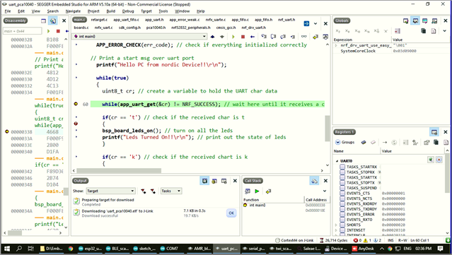

    1. Can you use the debugger and see if the program asserts?
    Yes, please check this
    please check below code ,

    I tested your example with a PC terminal and it worked I just had to adjust the argument in the error handler from app_uart_evt_type_t to app_uart_evt_t:
    // A simple error handler for uart if something goes wrong...
    void uart_err_handle(app_uart_evt_t * p)
    All LEDs was turned on when I sent the t character.
