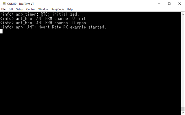

    I was mising log_init() sorry. Ok now I have downloaded clean SDK_17.0.2 and s212_7.0.1 to make sure there isn't any of my code inside.
    - I have tested ANT HRM TX and RX example on 2 PCA10040 evaluation boards, and I do get the data over the serial terminal
    - I have added sd_ant_channel_close(HRM_CHANNEL_NUM); and it stops in HRM RX or TX example
    Code in main loop looks like:
        log_init();
        utils_setup();
        softdevice_setup();
        profile_setup();
        NRF_LOG_INFO("ANT+ Heart Rate RX example started.");

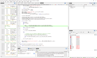

    - In debug (not release) mode the code is running without restarting (before in my own code it did restart - because log_init() was missing I think)
    - It does pass ant_close_channel(); because 32-bit unsigned variable counter_1 does increase to around 9000. But then it stops. As well when trying it for few times, the counter variable is never exactly same value when it stops

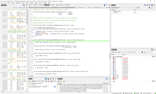

    - When pressing pause in debugging it always stops in nrfx_uart.c and nrfx_uart.h (attached images), it looks like it is looping
    - After that I have commented NRF_LOG_FINAL_FLUSH() and set breakpoint at switch (id)
    - "id" variable is 0x00004002 so I do end up in NRF_FAULT_ID_SDK_ASSERT
    Is the sequence of how I am using sd_ant_channel_close incorrect?

  • It seems to run fine here, what do you expect should happen if I run the HRM RX example project with your additional ant_close_channel()?
  • In a debug mode.
    It does stop because of some error. Please have a look at the video, 1. with ant_channel_close() counter stops and in video 2. when comentig out that function it counts normaly.
