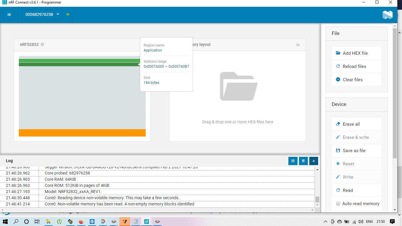

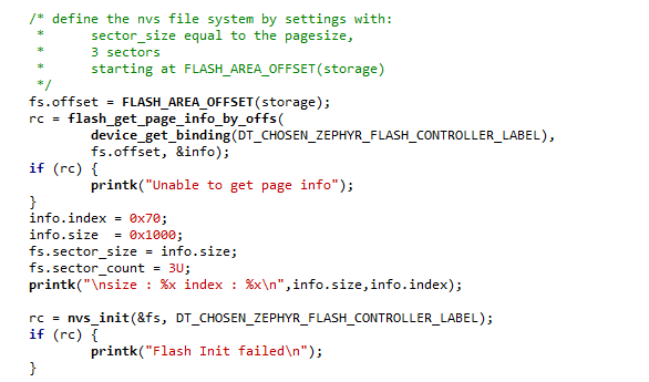

I have difficulty to change the data storage address. where we need to change the starting address. size of flash storage. If i use DFU how to assign the flash storage
I have checked this and print the info value
but I tried to change the value but it not write the given address

    The storage partition is statically defined by the device tree, here's an example for the nRF52840:
    https://github.com/nrfconnect/sdk-zephyr/blob/master/boards/arm/nrf52840dk_nrf52840/nrf52840dk_nrf52840.dts#L275-L278
    You'll find similar definitions for other devices, like the nrf52832:
    https://github.com/nrfconnect/sdk-zephyr/blob/master/boards/arm/nrf52dk_nrf52832/nrf52dk_nrf52832.dts#L220-L222
    When doing a DFU, you need to ensure that the storage_partition does not change between the original image and the dfu image.
