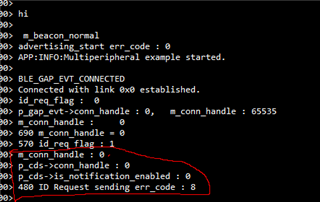

I'm now trying to implement the IOS Phones (Central) - Device (Peripheral) liver UART using Multiple Connection - Nordic Uart Service.
Devices tried to send a UART signal to the phone first, but it kept...
We could observe that 13313err_code or NRF_ERROR_INVALID_STATE Error occurred.
Looking at the log, it is confirmed that p_nus ->is_notification_enabled is false.
Can you tell me what caused this error?
Also, is the return value parameter p_nus->conn_handle in the ble_nus_string_send function specifying one of the Multiple Connection Devices?
