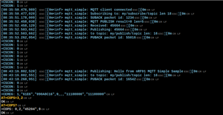

Hi Devzone,
I use the original MQTT_Sample example, just change "Client ID", "Alive Time" = 120s, use NBIoT + GPS.
Development set up:
ncs v1.5.1, ubuntu, thingy91
1. After a short time, the device receives CEREG notification, such as:
Is this normal or there is something wrong with my network?
2. After that, the Client keeps disconnect and connect continuously.
 Sorry for uploading lots of images, because my log file didn't contain enough log infor.
Maybe the NBIoT signal is weak, is there any solution for the device to work in a weak NBIoT area? I don't want the MQTT client to be disconnected so often.

2021-06-02T02:42:47.964Z DEBUG modem << [00:00:05.232,574] [0m<inf> mqtt_simple: The MQTT simple sample started[0m
2021-06-02T02:42:47.967Z DEBUG modem << [00:00:05.232,574] [0m<inf> mqtt_simple: Disabling PSM and eDRX[0m
2021-06-02T02:42:47.969Z DEBUG modem << [00:00:05.248,474] [0m<inf> mqtt_simple: LTE Link Connecting...[0m
2021-06-02T02:42:48.946Z DEBUG modem << +CEREG: 2,"61E6","090A8C16",9,0,0,"11100000","11100000"
2021-06-02T02:42:49.343Z DEBUG modem << +CSCON: 1
2021-06-02T02:42:50.746Z DEBUG modem << +CEREG: 1,"61E6","090A8C16",9,,,"11100000","11100000"
2021-06-02T02:42:50.767Z DEBUG modem >> AT+COPS=3,2
2021-06-02T02:42:50.773Z DEBUG modem << OK
2021-06-02T02:42:50.776Z DEBUG modem >> AT+COPS?
2021-06-02T02:42:50.783Z DEBUG modem << +COPS: 0,2,"45204",9
2021-06-02T02:42:50.785Z DEBUG modem << OK
2021-06-02T02:42:50.801Z DEBUG modem >> AT%XCBAND
2021-06-02T02:42:50.807Z DEBUG modem << %XCBAND: 3
2021-06-02T02:42:50.809Z DEBUG modem << OK
2021-06-02T02:42:50.817Z DEBUG modem >> AT+CGDCONT?
2021-06-02T02:42:50.829Z DEBUG modem << +CGDCONT: 0,"IP","nbiot","9.75.31.91",0,0
2021-06-02T02:42:50.831Z DEBUG modem << OK
2021-06-02T02:42:50.844Z DEBUG modem >> AT+CGACT?
2021-06-02T02:42:50.862Z DEBUG modem << +CGACT: 0,1
2021-06-02T02:42:50.864Z DEBUG modem << OK
2021-06-02T02:42:51.758Z DEBUG modem << [00:00:09.040,222] [0m<inf> mqtt_simple: LTE Link Connected![0m
2021-06-02T02:42:51.762Z DEBUG modem << [00:00:09.960,784] [0m<inf> mqtt_simple: IPv4 Address found 137.135.83.217[0m
2021-06-02T02:42:53.776Z DEBUG modem << [00:00:11.051,849] [0m<inf> mqtt_simple: MQTT client connected[0m
2021-06-02T02:42:53.779Z DEBUG modem << [00:00:11.051,849] [0m<inf> mqtt_simple: Subscribing to: my/subscribe/topic len 18[0m
2021-06-02T02:42:53.780Z DEBUG modem << [00:00:11.566,894] [0m<inf> mqtt_simple: SUBACK packet id: 1234[0m
2021-06-02T02:42:55.133Z DEBUG modem << [00:00:12.397,888] [0m<inf> mqtt_simple: MQTT PUBLISH result=0 len=5[0m
2021-06-02T02:42:55.137Z DEBUG modem << [00:00:12.397,979] [0m<inf> mqtt_simple: Received: 45664[0m
2021-06-02T02:42:55.141Z DEBUG modem << [00:00:12.443,420] [0m<inf> mqtt_simple: Publishing: 45664[0m
2021-06-02T02:42:55.144Z DEBUG modem << [00:00:12.443,420] [0m<inf> mqtt_simple: to topic: my/publish/topic len: 16[0m
2021-06-02T02:42:55.147Z DEBUG modem << [00:00:12.885,894] [0m<inf> mqtt_simple: PUBACK packet id: 26503[0m
2021-06-02T02:43:24.972Z DEBUG modem << +CSCON: 0
2021-06-02T02:44:54.462Z DEBUG modem << +CSCON: 1
2021-06-02T02:45:25.949Z DEBUG modem << +CSCON: 0
2021-06-02T02:46:54.453Z DEBUG modem << +CSCON: 1
2021-06-02T02:47:25.958Z DEBUG modem << +CSCON: 0
2021-06-02T02:48:54.451Z DEBUG modem << +CSCON: 1
2021-06-02T02:49:25.956Z DEBUG modem << +CSCON: 0
2021-06-02T02:50:54.770Z DEBUG modem << +CSCON: 1
2021-06-02T02:50:56.963Z DEBUG modem >> AT
2021-06-02T02:50:56.996Z DEBUG modem << OK
2021-06-02T02:51:26.906Z DEBUG modem << +CSCON: 0
2021-06-02T02:52:54.450Z DEBUG modem << +CSCON: 1
2021-06-02T02:53:25.946Z DEBUG modem << +CSCON: 0
2021-06-02T02:54:54.769Z DEBUG modem << +CSCON: 1
2021-06-02T02:55:26.915Z DEBUG modem << +CSCON: 0
2021-06-02T02:56:54.769Z DEBUG modem << +CSCON: 1
2021-06-02T02:57:26.905Z DEBUG modem << +CSCON: 0
2021-06-02T02:58:54.768Z DEBUG modem << +CSCON: 1
2021-06-02T02:59:26.916Z DEBUG modem << +CSCON: 0
2021-06-02T03:00:54.778Z DEBUG modem << +CSCON: 1
2021-06-02T03:01:26.930Z DEBUG modem << +CSCON: 0
2021-06-02T03:02:54.449Z DEBUG modem << +CSCON: 1
2021-06-02T03:03:25.955Z DEBUG modem << +CSCON: 0
2021-06-02T03:04:54.354Z DEBUG modem << +CEREG: 1,"FFFE","FFFFFFFF",9,,,"11100000","11100000"
2021-06-02T03:04:54.390Z DEBUG modem >> AT+COPS=3,2
2021-06-02T03:04:54.396Z DEBUG modem << OK
2021-06-02T03:04:54.398Z DEBUG modem >> AT+COPS?
2021-06-02T03:04:54.405Z DEBUG modem << +COPS: 0
2021-06-02T03:04:54.406Z DEBUG modem << OK
2021-06-02T03:04:54.424Z DEBUG modem >> AT%XCBAND
2021-06-02T03:04:54.431Z DEBUG modem << %XCBAND: 0
2021-06-02T03:04:54.433Z DEBUG modem << OK
2021-06-02T03:04:54.442Z DEBUG modem >> AT+CGDCONT?
2021-06-02T03:04:54.460Z DEBUG modem << +CGDCONT: 0,"IP","nbiot","9.75.31.91",0,0
2021-06-02T03:04:54.462Z DEBUG modem << OK
2021-06-02T03:04:54.471Z DEBUG modem >> AT+CGACT?
2021-06-02T03:04:54.489Z DEBUG modem << +CGACT: 0,1
2021-06-02T03:04:54.490Z DEBUG modem << OK
2021-06-02T03:04:54.834Z DEBUG modem << +CEREG: 1,"61E6","090A8C16",9,,,"11100000","11100000"
2021-06-02T03:04:54.866Z DEBUG modem >> AT+COPS=3,2
2021-06-02T03:04:54.872Z DEBUG modem << OK
2021-06-02T03:04:54.874Z DEBUG modem >> AT+COPS?
2021-06-02T03:04:54.890Z DEBUG modem << +COPS: 0,2,"45204",9
2021-06-02T03:04:54.892Z DEBUG modem << OK
2021-06-02T03:04:54.911Z DEBUG modem >> AT%XCBAND
2021-06-02T03:04:54.917Z DEBUG modem << %XCBAND: 3
2021-06-02T03:04:54.919Z DEBUG modem << OK
2021-06-02T03:04:54.936Z DEBUG modem >> AT+CGDCONT?
2021-06-02T03:04:54.956Z DEBUG modem << +CGDCONT: 0,"IP","nbiot","9.75.31.91",0,0
2021-06-02T03:04:54.958Z DEBUG modem << OK
2021-06-02T03:04:54.974Z DEBUG modem >> AT+CGACT?
2021-06-02T03:04:54.988Z DEBUG modem << +CGACT: 0,1
2021-06-02T03:04:54.989Z DEBUG modem << OK
2021-06-02T03:04:55.014Z DEBUG modem << +CEREG: 1,"FFFE","FFFFFFFF",9,,,"11100000","11100000"
2021-06-02T03:04:55.019Z DEBUG modem >> AT+COPS=3,2
2021-06-02T03:04:55.027Z DEBUG modem << OK
2021-06-02T03:04:55.059Z DEBUG modem >> AT+COPS?
2021-06-02T03:04:55.074Z DEBUG modem << +COPS: 0
2021-06-02T03:04:55.075Z DEBUG modem << OK
2021-06-02T03:04:55.092Z DEBUG modem >> AT%XCBAND
2021-06-02T03:04:55.108Z DEBUG modem << %XCBAND: 0
2021-06-02T03:04:55.109Z DEBUG modem << OK
2021-06-02T03:04:55.125Z DEBUG modem >> AT+CGDCONT?
2021-06-02T03:04:55.141Z DEBUG modem << +CGDCONT: 0,"IP","nbiot","9.75.31.91",0,0
2021-06-02T03:04:55.143Z DEBUG modem << OK
2021-06-02T03:04:55.159Z DEBUG modem >> AT+CGACT?
2021-06-02T03:04:55.175Z DEBUG modem << +CGACT: 0,1

    Are you outside or inside when testing?
    In the top right corner of LTE Link Monitor you can see the connection info, should look like this
    The CREG info loks fine.
    The MQTT_simple does not have GPS by default, could you share your project? If you dont want to share your code public we can make the ticket private.
    What sim card are you using and does other examples work, like the AssetTracker V2 or V1?
    Jonathan
    I use Local Provider sim card (Viettel), AssetTracker V1 work fine well.
    This is a disconnection from my newest project:
    I see that signal strength is about 1-2 collumns
    Is that cause from inside my code?
    mqtt_simple.rar
    My log file:
    2021-06-02T16_16_49.365Z-log.txt
  • It could be the broker that you use, is this issue consistent?
    And do you have the same issue if you use the mqtt_simple example without GPS modifications?
    Jonathan
  • This is my log file with original mqtt_simple. In this log file, there are 2 case with different mqtt alive time: Case 1 alivetime = 600s; case 2 alivetime = 120s.
    And the result:
    _Case1: Client easy to disconnect, It requires RRC must "Connect" more time to contact with broker
    _case 2: More stable, when alivetime time's up, RRC only need 1 "Connect" attempt to contact with Broker
    Does alive time affect MQTT stability?
    If I must use short alivetime (case2), then PSM is useless, and I find dificult when try to integrate GPS with mqtt_simple

    2021-06-03T13:25:28.136Z DEBUG modem << [00:20:43.689,392] [0m<inf> mqtt_simple: MQTT client connected[0m
    2021-06-03T13:25:28.138Z DEBUG modem << [00:20:43.689,392] [0m<inf> mqtt_simple: Subscribing to: my/subscribe/topic len 18[0m
    2021-06-03T13:25:28.140Z DEBUG modem << [00:20:44.324,401] [0m<inf> mqtt_simple: SUBACK packet id: 1234[0m
    2021-06-03T13:25:29.837Z DEBUG modem << [00:20:45.379,425] [0m<inf> mqtt_simple: MQTT PUBLISH result=0 len=5[0m
    2021-06-03T13:25:29.839Z DEBUG modem << [00:20:45.379,516] [0m<inf> mqtt_simple: Received: 45664[0m
    2021-06-03T13:25:29.841Z DEBUG modem << [00:20:45.425,048] [0m<inf> mqtt_simple: Publishing: 45664[0m
    2021-06-03T13:25:29.844Z DEBUG modem << [00:20:45.425,048] [0m<inf> mqtt_simple: to topic: my/publish/topic len: 16[0m
    2021-06-03T13:25:29.848Z DEBUG modem << [00:20:45.929,443] [0m<inf> mqtt_simple: PUBACK packet id: 41025[0m
    2021-06-03T13:26:00.403Z DEBUG modem << +CSCON: 0
    2021-06-03T13:26:01.409Z DEBUG modem << [00:21:16.978,332] [0m<inf> mqtt_simple: RRC mode: Idle[0m
    2021-06-03T13:29:29.442Z DEBUG modem << +CSCON: 1
    2021-06-03T13:29:30.479Z DEBUG modem << [00:24:46.026,062] [0m<inf> mqtt_simple: RRC mode: Connected[0m
    2021-06-03T13:29:30.481Z DEBUG modem << [00:24:46.190,704] [0m<inf> mqtt_simple: MQTT PUBLISH result=0 len=0[0m
    2021-06-03T13:29:30.484Z DEBUG modem << [00:24:46.190,704] [0m<inf> mqtt_simple: Received: [0m
    2021-06-03T13:29:30.487Z DEBUG modem << [00:24:46.236,236] [0m<inf> mqtt_simple: Publishing: [0m
    2021-06-03T13:29:30.489Z DEBUG modem << [00:24:46.236,267] [0m<inf> mqtt_simple: to topic: my/publish/topic len: 16[0m
    2021-06-03T13:29:30.491Z DEBUG modem << [00:24:46.858,764] [0m<inf> mqtt_simple: PUBACK packet id: 36428[0m
    2021-06-03T13:29:33.928Z DEBUG modem << [00:24:49.481,628] [0m<inf> mqtt_simple: MQTT PUBLISH result=0 len=2[0m
    2021-06-03T13:29:33.932Z DEBUG modem << [00:24:49.481,750] [0m<inf> mqtt_simple: Received: gh[0m
    2021-06-03T13:29:33.939Z DEBUG modem << [00:24:49.527,282] [0m<inf> mqtt_simple: Publishing: gh[0m
    2021-06-03T13:29:33.945Z DEBUG modem << [00:24:49.527,282] [0m<inf> mqtt_simple: to topic: my/publish/topic len: 16[0m
    2021-06-03T13:29:33.948Z DEBUG modem << [00:24:49.901,672] [0m<inf> mqtt_simple: PUBACK packet id: 26516[0m
    2021-06-03T13:30:04.374Z DEBUG modem << +CSCON: 0
    2021-06-03T13:30:05.379Z DEBUG modem << [00:25:20.959,533] [0m<inf> mqtt_simple: RRC mode: Idle[0m
    2021-06-03T13:30:58.471Z INFO Modem port is opened
    2021-06-03T13:30:59.535Z DEBUG modem << +CEREG: 2,"61E7","09026616",9,0,0,"11100000","11100000"
    2021-06-03T13:31:00.544Z DEBUG modem << [00:00:03.671,508] [0m<inf> mqtt_simple: LTE cell changed: Cell ID: 151152150, Tracking area: 25063[0m
    2021-06-03T13:31:01.630Z DEBUG modem << +CSCON: 1
    2021-06-03T13:31:02.636Z DEBUG modem << [00:00:05.766,265] [0m<inf> mqtt_simple: RRC mode: Connected[0m
    2021-06-03T13:31:05.241Z DEBUG modem << +CEREG: 1,"61E7","09026616",9,,,"11100000","11100000"
    2021-06-03T13:31:06.271Z DEBUG modem << [00:00:09.378,326] [0m<inf> mqtt_simple: LTE Link Connected![0m
    2021-06-03T13:31:06.274Z DEBUG modem << [00:00:09.378,417] [0m<inf> mqtt_simple: Network registration status: Connected - home network[0m
    2021-06-03T13:31:06.278Z DEBUG modem << [00:00:09.378,448] [0m<inf> mqtt_simple: PSM parameter update: TAU: -1, Active time: -1[0m
    2021-06-03T13:31:06.280Z DEBUG modem << [00:00:09.920,898] [0m<inf> mqtt_simple: IPv4 Address found 137.135.83.217[0m
    2021-06-03T13:31:08.096Z DEBUG modem << [00:00:11.212,951] [0m<inf> mqtt_simple: MQTT client connected[0m
    2021-06-03T13:31:08.097Z DEBUG modem << [00:00:11.212,982] [0m<inf> mqtt_simple: Subscribing to: my/subscribe/topic len 18[0m
    2021-06-03T13:31:08.099Z DEBUG modem << [00:00:11.966,949] [0m<inf> mqtt_simple: SUBACK packet id: 1234[0m
    2021-06-03T13:31:11.700Z DEBUG modem << [00:00:14.806,060] [0m<inf> mqtt_simple: MQTT PUBLISH result=0 len=5[0m
    2021-06-03T13:31:11.702Z DEBUG modem << [00:00:14.806,152] [0m<inf> mqtt_simple: Received: 45664[0m
    2021-06-03T13:31:11.703Z DEBUG modem << [00:00:14.851,623] [0m<inf> mqtt_simple: Publishing: 45664[0m
    2021-06-03T13:31:11.705Z DEBUG modem << [00:00:14.851,623] [0m<inf> mqtt_simple: to topic: my/publish/topic len: 16[0m
    2021-06-03T13:31:11.706Z DEBUG modem << [00:00:15.410,095] [0m<inf> mqtt_simple: PUBACK packet id: 30408[0m
    2021-06-03T13:31:41.748Z DEBUG modem << +CSCON: 0
    2021-06-03T13:31:42.753Z DEBUG modem << [00:00:45.885,955] [0m<inf> mqtt_simple: RRC mode: Idle[0m
    2021-06-03T13:31:42.813Z DEBUG modem << +CEREG: 1,"61E7","0076EB17",9,,,"11100000","11100000"
    2021-06-03T13:31:43.822Z DEBUG modem << [00:00:46.951,843] [0m<inf> mqtt_simple: LTE cell changed: Cell ID: 7793431, Tracking area: 25063[0m
    2021-06-03T13:32:03.039Z DEBUG modem << +CSCON: 1
    2021-06-03T13:32:03.919Z DEBUG modem << [00:01:07.178,894] [0m<inf> mqtt_simple: RRC mode: Connected[0m
    2021-06-03T13:32:03.920Z DEBUG modem << [00:01:07.343,475] [0m<inf> mqtt_simple: MQTT PUBLISH result=0 len=3[0m
    2021-06-03T13:32:03.923Z DEBUG modem << [00:01:07.343,566] [0m<inf> mqtt_simple: Received: gha[0m
    2021-06-03T13:32:03.924Z DEBUG modem << [00:01:07.389,099] [0m<inf> mqtt_simple: Publishing: gha[0m
    2021-06-03T13:32:03.925Z DEBUG modem << [00:01:07.389,099] [0m<inf> mqtt_simple: to topic: my/publish/topic len: 16[0m
    2021-06-03T13:32:03.926Z DEBUG modem << [00:01:08.008,453] [0m<inf> mqtt_simple: MQTT client disconnected: -57[0m
    2021-06-03T13:32:03.928Z DEBUG modem << [00:01:08.008,483] [1;31m<err> mqtt_simple: mqtt_input: -57[0m
    2021-06-03T13:32:03.929Z DEBUG modem << [00:01:08.008,483] [0m<inf> mqtt_simple: Disconnecting MQTT client...[0m
    2021-06-03T13:32:03.947Z DEBUG modem << [00:01:08.008,483] [1;31m<err> mqtt_simple: Could not disconnect MQTT client: -57[0m
    2021-06-03T13:32:03.949Z DEBUG modem << [00:01:08.008,514] [0m<inf> mqtt_simple: Reconnecting in 60 seconds...[0m
    2021-06-03T13:32:04.098Z DEBUG modem << +CEREG: 2,"61E7","0076EB17",9,0,0,"11100000","11100000"
    2021-06-03T13:32:04.324Z DEBUG modem << +CSCON: 0
    2021-06-03T13:32:04.961Z DEBUG modem << +CSCON: 1
    2021-06-03T13:32:05.336Z DEBUG modem << [00:01:08.464,416] [0m<inf> mqtt_simple: RRC mode: Idle[0m
    2021-06-03T13:32:05.337Z DEBUG modem << [00:01:09.099,792] [0m<inf> mqtt_simple: RRC mode: Connected[0m
    2021-06-03T13:32:05.539Z DEBUG modem << +CEREG: 1,"61E7","0076EB17",9,,,"11100000","11100000"
    2021-06-03T13:32:06.548Z DEBUG modem << [00:01:09.678,741] [0m<inf> mqtt_simple: Network registration status: Connected - home network[0m
    2021-06-03T13:32:36.009Z DEBUG modem << +CSCON: 0
    2021-06-03T13:32:37.015Z DEBUG modem << [00:01:40.150,207] [0m<inf> mqtt_simple: RRC mode: Idle[0m
    2021-06-03T13:33:04.478Z DEBUG modem << +CSCON: 1
    2021-06-03T13:33:05.484Z DEBUG modem << [00:02:08.620,361] [0m<inf> mqtt_simple: RRC mode: Connected[0m
    2021-06-03T13:33:06.716Z DEBUG modem << [00:02:09.838,928] [0m<inf> mqtt_simple: MQTT client connected[0m
    2021-06-03T13:33:06.718Z DEBUG modem << [00:02:09.838,958] [0m<inf> mqtt_simple: Subscribing to: my/subscribe/topic len 18[0m
    2021-06-03T13:33:06.719Z DEBUG modem << [00:02:10.444,946] [0m<inf> mqtt_simple: SUBACK packet id: 1234[0m
    2021-06-03T13:33:08.807Z DEBUG modem << [00:02:11.917,968] [0m<inf> mqtt_simple: MQTT PUBLISH result=0 len=5[0m
    2021-06-03T13:33:08.808Z DEBUG modem << [00:02:11.918,090] [0m<inf> mqtt_simple: Received: 45664[0m
    2021-06-03T13:33:08.810Z DEBUG modem << [00:02:11.963,562] [0m<inf> mqtt_simple: Publishing: 45664[0m
    2021-06-03T13:33:08.812Z DEBUG modem << [00:02:11.963,592] [0m<inf> mqtt_simple: to topic: my/publish/topic len: 16[0m
    2021-06-03T13:33:08.813Z DEBUG modem << [00:02:12.459,991] [0m<inf> mqtt_simple: PUBACK packet id: 63672[0m
    2021-06-03T13:33:39.275Z DEBUG modem << +CSCON: 0
    2021-06-03T13:33:40.281Z DEBUG modem << [00:02:43.418,884] [0m<inf> mqtt_simple: RRC mode: Idle[0m
    2021-06-03T13:34:43.036Z DEBUG modem << +CSCON: 1
    2021-06-03T13:34:43.231Z DEBUG modem << +CEREG: 1,"61E7","0076EB17",9,,,"00000100","00011100"
    2021-06-03T13:34:43.634Z DEBUG modem << +CSCON: 0
    2021-06-03T13:34:44.055Z DEBUG modem << [00:03:47.182,891] [0m<inf> mqtt_simple: RRC mode: Connected[0m
    2021-06-03T13:34:44.057Z DEBUG modem << [00:03:47.378,753] [0m<inf> mqtt_simple: PSM parameter update: TAU: 16800, Active time: 8[0m
    2021-06-03T13:34:44.058Z DEBUG modem << [00:03:47.780,487] [0m<inf> mqtt_simple: RRC mode: Idle[0m
    2021-06-03T13:43:09.041Z DEBUG modem << +CEREG: 1,"61E7","09026616",9,,,"00000100","00011100"
    2021-06-03T13:43:10.050Z DEBUG modem << [00:12:13.209,503] [0m<inf> mqtt_simple: LTE cell changed: Cell ID: 151152150, Tracking area: 25063[0m
    2021-06-03T13:43:11.552Z DEBUG modem << +CSCON: 1
    2021-06-03T13:43:12.573Z DEBUG modem << [00:12:15.720,947] [0m<inf> mqtt_simple: RRC mode: Connected[0m
    2021-06-03T13:43:12.575Z DEBUG modem << [00:12:16.534,576] [0m<inf> mqtt_simple: MQTT client disconnected: -57[0m
    2021-06-03T13:43:12.577Z DEBUG modem << [00:12:16.534,576] [1;31m<err> mqtt_simple: mqtt_input: -57[0m
    2021-06-03T13:43:12.595Z DEBUG modem << [00:12:16.534,576] [0m<inf> mqtt_simple: Disconnecting MQTT client...[0m
    2021-06-03T13:43:12.598Z DEBUG modem << [00:12:16.534,606] [1;31m<err> mqtt_simple: Could not disconnect MQTT client: -57[0m
    2021-06-03T13:43:12.600Z DEBUG modem << [00:12:16.534,606] [0m<inf> mqtt_simple: Reconnecting in 60 seconds...[0m
    2021-06-03T13:43:12.622Z DEBUG modem << +CEREG: 2,"61E7","09026616",9,0,0,"11100000","11100000"
    2021-06-03T13:43:12.899Z DEBUG modem << +CSCON: 0
    2021-06-03T13:43:13.904Z DEBUG modem << [00:12:17.067,474] [0m<inf> mqtt_simple: RRC mode: Idle[0m
    2021-06-03T13:43:15.377Z DEBUG modem << +CSCON: 1
    2021-06-03T13:43:16.140Z DEBUG modem << +CEREG: 1,"61E7","09026616",9,,,"00000100","00011101"
    2021-06-03T13:43:16.401Z DEBUG modem << [00:12:19.545,959] [0m<inf> mqtt_simple: RRC mode: Connected[0m
    2021-06-03T13:43:16.402Z DEBUG modem << [00:12:20.309,844] [0m<inf> mqtt_simple: Network registration status: Connected - home network[0m
    2021-06-03T13:43:16.404Z DEBUG modem << [00:12:20.309,844] [0m<inf> mqtt_simple: PSM parameter update: TAU: 17400, Active time: 8[0m
    2021-06-03T13:43:46.752Z DEBUG modem << +CSCON: 0
    2021-06-03T13:43:47.757Z DEBUG modem << [00:12:50.922,332] [0m<inf> mqtt_simple: RRC mode: Idle[0m
    2021-06-03T13:44:12.960Z DEBUG modem << +CEREG: 1,"61E7","0076EB17",9,,,"00000100","00011101"
    2021-06-03T13:44:13.586Z DEBUG modem << +CSCON: 1
    2021-06-03T13:44:13.975Z DEBUG modem << [00:13:17.131,103] [0m<inf> mqtt_simple: LTE cell changed: Cell ID: 7793431, Tracking area: 25063[0m
    2021-06-03T13:44:13.976Z DEBUG modem << [00:13:17.757,476] [0m<inf> mqtt_simple: RRC mode: Connected[0m
    2021-06-03T13:44:14.198Z DEBUG modem << +CEREG: 2,"61E7","0076EB17",9,0,0,"11100000","11100000"
    2021-06-03T13:44:14.410Z DEBUG modem << +CSCON: 0
    2021-06-03T13:44:15.052Z DEBUG modem << [00:13:18.205,200] [1;31m<err> mqtt_simple: mqtt_connect -60[0m
    2021-06-03T13:44:15.055Z DEBUG modem << [00:13:18.205,230] [0m<inf> mqtt_simple: Reconnecting in 60 seconds...[0m
    2021-06-03T13:44:15.057Z DEBUG modem << [00:13:18.581,024] [0m<inf> mqtt_simple: RRC mode: Idle[0m
    2021-06-03T13:44:15.441Z DEBUG modem << +CEREG: 2,"61E7","09026616",9,0,0,"11100000","11100000"
    2021-06-03T13:44:15.837Z DEBUG modem << +CSCON: 1
    2021-06-03T13:44:16.405Z DEBUG modem << +CEREG: 1,"61E7","09026616",9,,,"00000100","00011100"
    2021-06-03T13:44:16.474Z DEBUG modem << [00:13:19.612,548] [0m<inf> mqtt_simple: LTE cell changed: Cell ID: 151152150, Tracking area: 25063[0m
    2021-06-03T13:44:16.475Z DEBUG modem << [00:13:20.007,446] [0m<inf> mqtt_simple: RRC mode: Connected[0m
    2021-06-03T13:44:16.477Z DEBUG modem << [00:13:20.576,385] [0m<inf> mqtt_simple: Network registration status: Connected - home network[0m
    2021-06-03T13:44:16.478Z DEBUG modem << [00:13:20.576,416] [0m<inf> mqtt_simple: PSM parameter update: TAU: 16800, Active time: 8[0m
    2021-06-03T13:44:46.789Z DEBUG modem << +CSCON: 0
    2021-06-03T13:44:47.794Z DEBUG modem << [00:13:50.961,853] [0m<inf> mqtt_simple: RRC mode: Idle[0m
    2021-06-03T13:44:48.719Z DEBUG modem << +CEREG: 1,"61E7","0076EB17",9,,,"00000100","00011100"
    2021-06-03T13:44:49.728Z DEBUG modem << [00:13:52.891,784] [0m<inf> mqtt_simple: LTE cell changed: Cell ID: 7793431, Tracking area: 25063[0m
    2021-06-03T13:45:14.719Z DEBUG modem << +CEREG: 1,"61E7","09026616",9,,,"00000100","00011100"
    2021-06-03T13:45:15.696Z DEBUG modem << +CSCON: 1
    2021-06-03T13:45:15.734Z DEBUG modem << [00:14:18.892,639] [0m<inf> mqtt_simple: LTE cell changed: Cell ID: 151152150, Tracking area: 25063[0m
    2021-06-03T13:45:15.735Z DEBUG modem << [00:14:19.870,025] [0m<inf> mqtt_simple: RRC mode: Connected[0m
    2021-06-03T13:45:18.135Z DEBUG modem << [00:14:21.289,581] [0m<inf> mqtt_simple: MQTT client connected[0m
    2021-06-03T13:45:18.137Z DEBUG modem << [00:14:21.289,581] [0m<inf> mqtt_simple: Subscribing to: my/subscribe/topic len 18[0m
    2021-06-03T13:45:18.139Z DEBUG modem << [00:14:21.954,620] [0m<inf> mqtt_simple: SUBACK packet id: 1234[0m
    2021-06-03T13:45:19.286Z DEBUG modem << [00:14:22.428,558] [0m<inf> mqtt_simple: MQTT PUBLISH result=0 len=5[0m
    2021-06-03T13:45:19.287Z DEBUG modem << [00:14:22.428,649] [0m<inf> mqtt_simple: Received: 45664[0m
    2021-06-03T13:45:19.289Z DEBUG modem << [00:14:22.474,151] [0m<inf> mqtt_simple: Publishing: 45664[0m
    2021-06-03T13:45:19.290Z DEBUG modem << [00:14:22.474,151] [0m<inf> mqtt_simple: to topic: my/publish/topic len: 16[0m
    2021-06-03T13:45:19.291Z DEBUG modem << [00:14:23.074,645] [0m<inf> mqtt_simple: PUBACK packet id: 33996[0m
    2021-06-03T13:45:49.957Z DEBUG modem << +CSCON: 0
    2021-06-03T13:45:50.558Z DEBUG modem << +CEREG: 1,"61E7","0076EB17",9,,,"00000100","00011100"
    2021-06-03T13:45:50.972Z DEBUG modem << [00:14:54.132,537] [0m<inf> mqtt_simple: RRC mode: Idle[0m
    2021-06-03T13:45:50.973Z DEBUG modem << [00:14:54.733,398] [0m<inf> mqtt_simple: LTE cell changed: Cell ID: 7793431, Tracking area: 25063[0m
    2021-06-03T13:51:07.771Z DEBUG modem >> AT+CPSMS=0
    2021-06-03T13:51:07.810Z DEBUG modem << OK
    2021-06-03T13:51:08.939Z DEBUG modem << +CSCON: 1
    2021-06-03T13:51:09.134Z DEBUG modem << +CEREG: 1,"61E7","0076EB17",9,,,"11100000","11100000"
    2021-06-03T13:51:09.536Z DEBUG modem << +CSCON: 0
    2021-06-03T13:51:09.958Z DEBUG modem << [00:20:13.128,112] [0m<inf> mqtt_simple: RRC mode: Connected[0m
    2021-06-03T13:51:09.960Z DEBUG modem << [00:20:13.323,974] [0m<inf> mqtt_simple: PSM parameter update: TAU: -1, Active time: -1[0m
    2021-06-03T13:51:09.961Z DEBUG modem << [00:20:13.725,708] [0m<inf> mqtt_simple: RRC mode: Idle[0m
    //Part2______________________________________XXXXXXXXXXXXXXXXXXXXXXXXXXXXXXXXXX_____________________________________________________________________________
    2021-06-03T13:59:00.445Z INFO Modem port is opened
    2021-06-03T13:59:01.584Z DEBUG modem << +CEREG: 2,"61E7","09026616",9,0,0,"11100000","11100000"
    2021-06-03T13:59:02.593Z DEBUG modem << [00:00:06.765,502] [0m<inf> mqtt_simple: LTE cell changed: Cell ID: 151152150, Tracking area: 25063[0m
    2021-06-03T13:59:39.826Z DEBUG modem << +CEREG: 2,"FFFE","FFFFFFFF",9,0,0,"11100000","11100000"
    2021-06-03T13:59:40.835Z DEBUG modem << [00:00:45.009,704] [0m<inf> mqtt_simple: LTE cell changed: Cell ID: -1, Tracking area: 65534[0m
    2021-06-03T13:59:42.142Z DEBUG modem << +CEREG: 2,"61E7","0076EB17",9,0,0,"11100000","11100000"
    2021-06-03T13:59:43.151Z DEBUG modem << [00:00:47.325,714] [0m<inf> mqtt_simple: LTE cell changed: Cell ID: 7793431, Tracking area: 25063[0m
    2021-06-03T13:59:50.218Z DEBUG modem << +CSCON: 1
    2021-06-03T13:59:51.224Z DEBUG modem << [00:00:55.402,374] [0m<inf> mqtt_simple: RRC mode: Connected[0m
    2021-06-03T13:59:51.556Z DEBUG modem << +CEREG: 1,"61E7","0076EB17",9,,,"11100000","11100000"
    2021-06-03T13:59:52.580Z DEBUG modem << [00:00:56.740,447] [0m<inf> mqtt_simple: LTE Link Connected![0m
    2021-06-03T13:59:52.581Z DEBUG modem << [00:00:56.740,509] [0m<inf> mqtt_simple: Network registration status: Connected - home network[0m
    2021-06-03T13:59:52.583Z DEBUG modem << [00:00:56.740,539] [0m<inf> mqtt_simple: PSM parameter update: TAU: -1, Active time: -1[0m
    2021-06-03T13:59:53.625Z DEBUG modem << [00:00:57.802,001] [0m<inf> mqtt_simple: IPv4 Address found 137.135.83.217[0m
    2021-06-03T13:59:54.781Z DEBUG modem << [00:00:58.945,098] [0m<inf> mqtt_simple: MQTT client connected[0m
    2021-06-03T13:59:54.782Z DEBUG modem << [00:00:58.945,129] [0m<inf> mqtt_simple: Subscribing to: my/subscribe/topic len 18[0m
    2021-06-03T13:59:54.784Z DEBUG modem << [00:00:59.488,128] [0m<inf> mqtt_simple: SUBACK packet id: 1234[0m
    2021-06-03T13:59:56.012Z DEBUG modem << [00:01:00.165,130] [0m<inf> mqtt_simple: MQTT PUBLISH result=0 len=5[0m
    2021-06-03T13:59:56.013Z DEBUG modem << [00:01:00.165,222] [0m<inf> mqtt_simple: Received: 45664[0m
    2021-06-03T13:59:56.014Z DEBUG modem << [00:01:00.210,693] [0m<inf> mqtt_simple: Publishing: 45664[0m
    2021-06-03T13:59:56.016Z DEBUG modem << [00:01:00.210,693] [0m<inf> mqtt_simple: to topic: my/publish/topic len: 16[0m
    2021-06-03T13:59:56.017Z DEBUG modem << [00:01:00.685,150] [0m<inf> mqtt_simple: PUBACK packet id: 17972[0m
    2021-06-03T14:00:26.232Z DEBUG modem << +CSCON: 0
    2021-06-03T14:00:27.237Z DEBUG modem << [00:01:31.417,999] [0m<inf> mqtt_simple: RRC mode: Idle[0m
    2021-06-03T14:01:55.337Z DEBUG modem << +CSCON: 1
    2021-06-03T14:01:56.342Z DEBUG modem << [00:03:00.525,634] [0m<inf> mqtt_simple: RRC mode: Connected[0m
    2021-06-03T14:02:26.821Z DEBUG modem << +CSCON: 0
    2021-06-03T14:02:27.827Z DEBUG modem << [00:03:32.012,054] [0m<inf> mqtt_simple: RRC mode: Idle[0m
    2021-06-03T14:03:55.324Z DEBUG modem << +CSCON: 1
    2021-06-03T14:03:56.330Z DEBUG modem << [00:05:00.518,737] [0m<inf> mqtt_simple: RRC mode: Connected[0m
    2021-06-03T14:04:26.829Z DEBUG modem << +CSCON: 0
    2021-06-03T14:04:27.834Z DEBUG modem << [00:05:32.025,115] [0m<inf> mqtt_simple: RRC mode: Idle[0m
    2021-06-03T14:05:55.323Z DEBUG modem << +CSCON: 1
    2021-06-03T14:05:56.328Z DEBUG modem << [00:07:00.521,759] [0m<inf> mqtt_simple: RRC mode: Connected[0m
    2021-06-03T14:06:26.827Z DEBUG modem << +CSCON: 0
    2021-06-03T14:06:27.832Z DEBUG modem << [00:07:32.028,167] [0m<inf> mqtt_simple: RRC mode: Idle[0m
    2021-06-03T14:07:55.320Z DEBUG modem << +CSCON: 1
    2021-06-03T14:07:56.326Z DEBUG modem << [00:09:00.524,841] [0m<inf> mqtt_simple: RRC mode: Connected[0m
    2021-06-03T14:08:26.866Z DEBUG modem << +CSCON: 0
    2021-06-03T14:08:27.820Z DEBUG modem << [00:09:32.021,209] [0m<inf> mqtt_simple: RRC mode: Idle[0m
    2021-06-03T14:09:22.999Z DEBUG modem << +CSCON: 1
    2021-06-03T14:09:24.035Z DEBUG modem << [00:10:28.207,061] [0m<inf> mqtt_simple: RRC mode: Connected[0m
    2021-06-03T14:09:24.038Z DEBUG modem << [00:10:28.371,643] [0m<inf> mqtt_simple: MQTT PUBLISH result=0 len=3[0m
    2021-06-03T14:09:24.050Z DEBUG modem << [00:10:28.371,734] [0m<inf> mqtt_simple: Received: gha[0m
    2021-06-03T14:09:24.052Z DEBUG modem << [00:10:28.417,266] [0m<inf> mqtt_simple: Publishing: gha[0m
    2021-06-03T14:09:24.054Z DEBUG modem << [00:10:28.417,297] [0m<inf> mqtt_simple: to topic: my/publish/topic len: 16[0m
    2021-06-03T14:09:24.056Z DEBUG modem << [00:10:28.879,577] [0m<inf> mqtt_simple: PUBACK packet id: 56699[0m
    2021-06-03T14:09:55.115Z DEBUG modem << +CSCON: 0
    2021-06-03T14:09:56.121Z DEBUG modem << [00:11:00.325,439] [0m<inf> mqtt_simple: RRC mode: Idle[0m
    2021-06-03T14:11:23.646Z DEBUG modem << +CSCON: 1
    2021-06-03T14:11:24.652Z DEBUG modem << [00:12:28.860,107] [0m<inf> mqtt_simple: RRC mode: Connected[0m
    2021-06-03T14:11:55.131Z DEBUG modem << +CSCON: 0
    2021-06-03T14:11:56.136Z DEBUG modem << [00:13:00.346,527] [0m<inf> mqtt_simple: RRC mode: Idle[0m
    2021-06-03T14:13:23.634Z DEBUG modem << +CSCON: 1
    2021-06-03T14:13:24.640Z DEBUG modem << [00:14:28.853,179] [0m<inf> mqtt_simple: RRC mode: Connected[0m
    2021-06-03T14:13:55.139Z DEBUG modem << +CSCON: 0
    2021-06-03T14:13:56.144Z DEBUG modem << [00:15:00.359,588] [0m<inf> mqtt_simple: RRC mode: Idle[0m
    2021-06-03T14:14:22.513Z DEBUG modem << +CSCON: 1
    2021-06-03T14:14:22.708Z DEBUG modem << +CEREG: 1,"61E7","0076EB17",9,,,"00000100","00011011"
    2021-06-03T14:14:23.111Z DEBUG modem << +CSCON: 0
    2021-06-03T14:14:23.533Z DEBUG modem << [00:15:27.734,680] [0m<inf> mqtt_simple: RRC mode: Connected[0m
    2021-06-03T14:14:23.535Z DEBUG modem << [00:15:27.930,541] [0m<inf> mqtt_simple: PSM parameter update: TAU: 16200, Active time: 8[0m
    2021-06-03T14:14:23.536Z DEBUG modem << [00:15:28.332,305] [0m<inf> mqtt_simple: RRC mode: Idle[0m
    2021-06-03T14:15:24.281Z DEBUG modem << +CSCON: 1
    2021-06-03T14:15:25.288Z DEBUG modem << [00:16:29.506,225] [0m<inf> mqtt_simple: RRC mode: Connected[0m
    2021-06-03T14:15:55.797Z DEBUG modem << +CSCON: 0
    2021-06-03T14:15:56.802Z DEBUG modem << [00:17:01.022,674] [0m<inf> mqtt_simple: RRC mode: Idle[0m
    2021-06-03T14:17:24.269Z DEBUG modem << +CSCON: 1
    2021-06-03T14:17:25.275Z DEBUG modem << [00:18:29.499,328] [0m<inf> mqtt_simple: RRC mode: Connected[0m
    2021-06-03T14:17:55.775Z DEBUG modem << +CSCON: 0
    2021-06-03T14:17:56.780Z DEBUG modem << [00:19:01.005,737] [0m<inf> mqtt_simple: RRC mode: Idle[0m
    2021-06-03T14:19:24.267Z DEBUG modem << +CSCON: 1
    2021-06-03T14:19:25.314Z DEBUG modem << [00:20:29.502,410] [0m<inf> mqtt_simple: RRC mode: Connected[0m
    2021-06-03T14:19:25.316Z DEBUG modem << [00:20:30.472,900] [0m<inf> mqtt_simple: MQTT PUBLISH result=0 len=3[0m
    2021-06-03T14:19:25.317Z DEBUG modem << [00:20:30.472,991] [0m<inf> mqtt_simple: Received: gha[0m
    2021-06-03T14:19:25.318Z DEBUG modem << [00:20:30.518,554] [0m<inf> mqtt_simple: Publishing: gha[0m
    2021-06-03T14:19:25.319Z DEBUG modem << [00:20:30.518,554] [0m<inf> mqtt_simple: to topic: my/publish/topic len: 16[0m
    2021-06-03T14:19:28.506Z DEBUG modem << [00:20:32.734,985] [0m<inf> mqtt_simple: PUBACK packet id: 18555[0m
    2021-06-03T14:19:58.484Z DEBUG modem << +CSCON: 0
    2021-06-03T14:19:59.489Z DEBUG modem << [00:21:03.720,886] [0m<inf> mqtt_simple: RRC mode: Idle[0m
    2021-06-03T14:20:45.409Z INFO Modem port is closed
