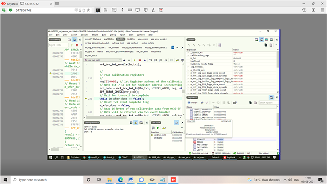

I am working on nrf52832 custom board, using sdk 15.0.0.
I referred example/peripherals/twi_sesnor example as reference. I am trying to interface LIS2dw12 with nrf52832.
While debugging, I found that the board gets stuck in the "while (m_xfer_done == false)" loop inside the function that writes to the board to read data from the board.
please help me slove this error.
  • Are you setting the variable to true in the interrupt handler and is the variable declared volatile?
  • thanks for reply,
    this flag is true in interrupt handler and this variable declared as volatile.
    still stuck.
  • thanks for reply,
    i checked interrupt handler is called. I checked in register setting Event is triggred.
    // TWI events handler.
    void twi_handler(nrf_drv_twi_evt_t const * p_event, void * p_context)
        switch (p_event->type)
            // TWI event completed
            // If data was being read, jump to the data handler
            // Otherwise, assume it was a transmit and just indicate transfer is done
            case NRF_DRV_TWI_EVT_DONE:
                if (p_event->xfer_desc.type == NRF_DRV_TWI_XFER_RX) // Reading data
                  if (reg[0] == HTS221_WHO_AM_I) // Reading from HTS221 WHO_AM_I register
                  id_handler(m_sample);
                 if (reg[0] == HTS221_CTRL_REG1) // Reading CTRL_REG1
                    reg1_handler(m_sample);
                  if (reg[0] == 0xB0) // Reading the calibration data
                   calibration_handler(calibration_regs);
                  if (reg[0] == 0xAA) // Reading the temperature registers
                    temperature_handler(raw_temp);
                 if (reg[0] == HTS221_STATUS_REG) // Reading the status register
                    status_handler(m_sample);
                if (reg[0] == 0xA8)  // Reading the humidity registers
                   humidity_handler(raw_hum);
               m_xfer_done = true;
            // m_xfer_done = false;
            default:
    // TWI initialization.
    void twi_init (void)
        ret_code_t err_code;
        const nrf_drv_twi_config_t twi_hts221_config = {
           .scl                =SCL_PIN,
           .sda                =SDA_PIN,
           .frequency          = NRF_DRV_TWI_FREQ_100K,
           .interrupt_priority = APP_IRQ_PRIORITY_HIGH,
           .clear_bus_init     = false
        err_code = nrf_drv_twi_init(&m_twi, &twi_hts221_config, twi_handler, NULL);
        printf("init: %d\n",err_code);
        nrf_drv_twi_enable(&m_twi);
        // read calibration registers
        reg[0]=0xB0; // 1st Register address of the calibration registers
        // Note bit 7 is set for register address incrementing. 0x30 | 0x80
        err_code = nrf_drv_twi_tx(&m_twi, HTS221_ADDR, reg, sizeof(reg),true);
        // Wait for transmit to complete
        while (m_xfer_done == false);
        // Reset TWI event complete flag
        // Read 16 bytes of raw calibration data from 0x30-3F
        // Data will be returned via twi event handler
        err_code = nrf_drv_twi_rx(&m_twi, HTS221_ADDR, calibration_regs, sizeof(calibration_regs));
    if anymore required let me know. few days ago I was tested this code it works fine.it gives us temperature and humidity exact value match with surrounding temp.
  • Hi forum,
    I tried to change interrupt priority to low it works once. after redumped code its not working.
    please help me to slove this problem.
    Is the flag declared as static volatile? Can you set a breakpoint at 27 and upload a screenshot from debug view that shows that the handler is called and the variable is set to true. Also, what other modules/peripherals do you use? Is the Softdevice used?
    regards
    Jared
