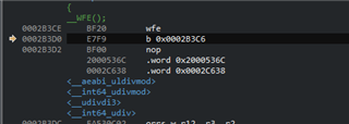

    Instead of showing the disassembly, could you show where in the source code it's stuck before the CS is asserted by the master. I'm assuming that the nRF acts as a slave and you're using the SPIS peripheral?
    nRF52833 i use pca10100e with s140
     The correct development kit for the nRF52833 is PCA10100.
    regards
    Jared
    Thank you for fast reply!
    Yes you are correct. I use the nRF as a slave.
    I have added the spis files required to the project, and will later on clean out the stuff i don't need (uart,...)
    Ok, so i went and modified required fields in sdk_config for PCA10100, but still same result.
    Was my bad for using wrong PCA, but still doesn't make the difference.
    I made spis.c/.h files to keep main clean.

    It apparently gets stuck in SPIS_ReadWrite(). If i remove while loop which has __WFE(); in it, the code starts.
    The function itself is called within following function in lxbt.c:
    void LXBT_Task(void)
      SPIS_ReadWrite(prSpiTxBuf, prSpiRxBuf);
      prSpisParser(prSpiRxBuf);

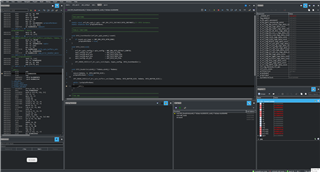

    Another screenshot of whole enviroment after i run debug:

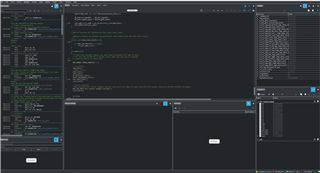

    and when i hit pause:

    AndrejP said:
    But the int main(void) doesn't even get called with 52833(i used a NRF_LOG_INFO at start of main to check that), while with 52832 this code works without issues...
    AndrejP said:
    But i don't see  NRF_LOG_INFO("BLE scanner example started!"), which is in main before LXBT_Task, being put into terminal....
    Exactly when the logger module prints the logs depends on if you're using deferred or in-place mode. Most of our examples use the logger mode in deferred mode, which means that the logs are only scheduled in a queue when NRF_LOG_INFO() is called, and actually first printed when NRF_LOG_INFO_FLUSH() is called. This would explain why you don't see the log being printed before it goes into the SPIS loop. It's a bit strange that it works with the nRF52832 and not with the nRF52833.Exactly which module do you use?

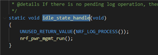

    It seems that you're using the Softdevice. Can you try to replace your WFE() with idle_state_handle() as in the softdevice examples and call that in teh SPIS loop:
