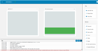

I am using the NRF9160DK, I have already made all the getting started and compiled an example to use the LEDs on the board with em studio. I had already connected my card to NRF programer without any problem. But today I wanted to update the firmware of the NRF9160 and I can't connect it to NRFprogramer. Do you have any idea what the problem is?
Thanks in advance for the help!
I put here the log file and terminal here

2021-06-02T09:08:38.681Z INFO Using nrfjprog library 10.12.1, pc-nrfjprog-js 1.7.6
2021-06-02T09:08:39.543Z ERROR Error while probing devices: Error occured when get serial numbers. Errorcode: CouldNotCallFunction (0x9)
Lowlevel error: INVALID_OPERATION (fffffffe)
2021-06-02T09:08:42.505Z INFO Using nrfjprog to communicate with target
2021-06-02T09:08:42.510Z ERROR Could not fetch memory size of target devkit: Error: Error occured when get library info. Errorcode: CouldNotOpenDevice (0x4)
