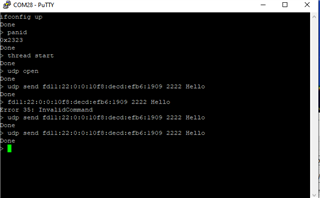

  • Hey,
    i did something very similar. I modified the CoAP examples, so i can used it for plain UDP transport.
    Sending is working... fine.
    If i send a message to my device my connected receiver callback is triggered, also fine. The otMessageInfo  shows the correct sender and receiver IPv6 addresses.
    But the message-pointer is pointing anywhere.
    static bool UDPReceiverCallback(void *aContext, otMessage* aMessage, const otMessageInfo *aMessageInfo) {
      volatile otMessage* receivedMessage = aMessage;
      uint8_t buffer[64];
      volatile uint32_t x =  aMessage->mNext;
      memcpy(&buffer, aMessage->mNext, 64);
      volatile otMessageInfo receivedMessageInfo = *(aMessageInfo);
      dk_set_led_on(DONGLE_GREEN_MULTI_LED);
    I just send a simple string "Hello".
    How do i handle the message? Is there any example?
    I just want to reconstruct the "Hello" string
    regards,
    Sören
    UDP is implemented in the CLI example. You can have a look at the implementation in OpenThread to see how received messages are parsed.
    Jørgen
