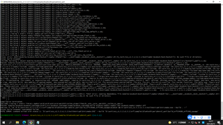

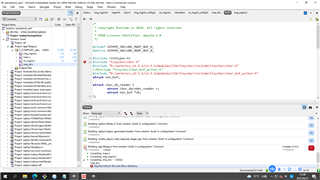

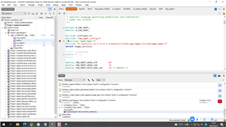

.when i input these path with exact path as #include<D:\work\v1.5.0\zephyr\include\bluetooth/bluetooth.h> , the bluetooth.h 's include header file cannot find
zhouhaifang said:Simon ,thank you .I have already knew how to flash nrf5340dk ,but how to DFU nrf5340dk is not know .i can not build the example in v1.5.0\zephyr\samples\subsys\mgmt\mcumgr\smp_svr using BLe to upgrade image must enable CONFIG_MCUMGR_SMP_BT and include bluetooth.c in src folder ,but bulid ,these are many errors.
You don't need to include bluetooth.h or enable CONFIG_MCUMGR_SMP_BT explicitly. Just add the line '- -DOVERLAY_CONFIG=overlay-bt.conf' when building with west, which should include the file overlay-bt.conf and set CONFIG_MCUMGR_SMP_BT.
