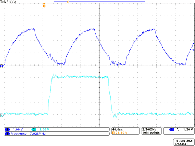

    I hooked up up my scope to measure the SPI-lines. This raised question about SPI-pin configuration. As you can see in the image below, the clock frequency is about 8MHz.

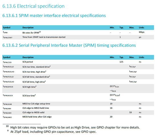

    The datasheet of the nRF9160 states, that the pins need to be configured as "High Drive" at high bit rates (footnote 10).
    Since i'm using the highest possible clock-frequency on the nRF9160, i tried to find out how to configure this option, but i wasn't able to find out how. Can you give me a hint on this one? On the other side the data-line looks well. I think it is possible that this is due to other input-capacitance on this line (SCK --> P0.19 / MISO --> P0.18) of the nRF9160DK Rev. 1.0.0.

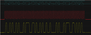

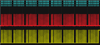

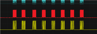

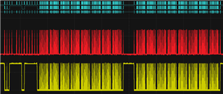

    When reading a file in chunks of 1024 bytes, we can see the reading-command followed by two blocks of 512 byte data.
    Each of these blocks contain eight 64-bytes subs.
    Each of these subs contain eight 64-bit bitfields.
    Each bitfiled contains 64-bit data.
    To ensure the reading sequence isn't blocked by network-threads, i tested the reading-command also with the networking and webserver disabled, both the same. From the timing perspective there seems to be quiet some potential to save time.
    Thanks for any help.
    Check out this answer for how to do this: https://devzone.nordicsemi.com/f/nordic-q-a/64647/spi-not-operating-correctly-at-high-speeds/264121#264121
    You can use the Nordic nrf functions (#include <hal/nrf_gpio.h>) directly and set it using nrf_gpio_cfg() like in the link above.
    You can also achieve this using the Zephyr layer, just make sure the following gets triggered: https://github.com/nrfconnect/sdk-zephyr/blob/v2.4.99-ncs2/drivers/gpio/gpio_nrfx.c#L155. I think you can do that by running gpio_config() (#include <drivers/gpio.h>) with flags = GPIO_DS_ALT_LOW | GPIO_DS_ALT_HIGH.

    the nrf_gpio_cfg() function worked very well. I was able to increase the waveform performance dramatically. I've done this with all the pins controlled by the nRF9160. Following the results of the spi-clk pin for example before and after the configuration.
