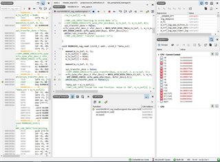

I request for your time and effort to solve the issue that I am facing at the moment. Any suggestions and solutions are highly appreciated.
Hardware: NRF52840DK , SPI sensor (MAX86141)
SDK: 17.02
SoftDevice : S140
I have successfully written code to communicate with one of the SPI sensor (MAX86141) that I have with me using nrfx_spim driver. I am using SPIM instance 3. Please find the details below:
Driver: NRFX_SPIM
Instance: 3
Priority: 6
SPI PINS: CS-> 31 , MOSI-> 29 , MISO-> 30 , SCLK-> 28
I can properly read and write to the sensor without any issues.
But now when I tried to add the BLE functionality to the project, I faces problem. I started with the ble_app_template program and then added my spi files for the sensor. I have also enabled NRFX_SPIM_ENABLE and NRFX_SPIM3_ENABLED in the SDK_config file. After adding all related headers and files, the program compile successfully.

When I run the program, the application get stuck in the while loop inside the read function as shown in the screenshot below.
Screenshot

As you can see from the debug information, the sensor is not responding. But when I use the same code without BLE, the sensor works fine.
Are there any configuration that I am missing out? I would really appreciate your help.
Update:
I checked with a scope. There are no activity in the spi lines. No clock, cs, miso and mosi. So i guess the driver is not working.
