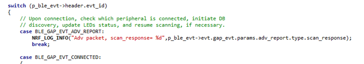

  • Hi ,
    I would suggest to do a quick test in one of the central example we have. You can just try to remove any filter we have and print out any advertising packet you receive. I did a quick test here and I can see many packets with scan_response bit = 1.
  • Hi Lorenzo,
    I added this to the ble_app_multiplink_central:
    And I can see that it can catch some scan response packets:
    (I changed connect if match = false)
    I attached the main.c file (I tested on SDK v15.2 but I don't think it would be much different to SDK v15.3)
    ble_app_multilink_central_pca10056_s140.zip
