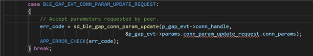

    One last error remain, I hope!
    union "<unnamed>" has no field "conn_param_update_request"
    referring to
            case BLE_GAP_EVT_CONN_PARAM_UPDATE_REQUEST:
                // Accept parameters requested by peer.
                err_code = sd_ble_gap_conn_param_update(p_gap_evt->conn_handle,
                                            &p_gap_evt->params.conn_param_update_request.conn_params);
            } break;
    in the
    static void ble_evt_handler(ble_evt_t const * p_ble_evtvoid * p_context)
    function.

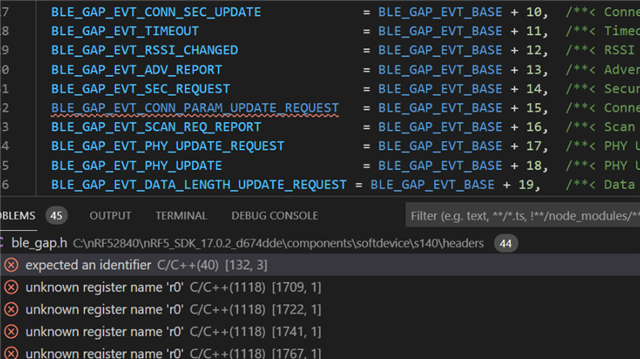

  • So this seems related to the last define I added : "BLE_GAP_EVT_CONN_PARAM_UPDATE_REQUEST",
    In ble_gap.h there is an error in the enum BLE_GAP_EVTS at the point where it is listed
    line 132
    BLE_GAP_EVT_CONN_PARAM_UPDATE_REQUEST   = BLE_GAP_EVT_BASE + 15,
    So something isn't right with my define perhaps?? Does it need a value?
  • Any ideas why this is causing an error please?
    It seems odd that it's just this and not all the rest?
    From this in main.c
