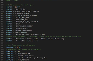

  • Spoke too soon, but here is a better list of defines that I grabbed by downloading and installing Segger SES and looking through the pre-processor options
                "defines": [
                    "APP_TIMER_V2",
                    "APP_TIMER_V2_RTC1_ENABLED",

    As fare as I am aware, look at the example you want to reference and take a peek at the makefile to see what defines are there.
    Then add the info to the json file in VSC, so that the .json and makfile match
