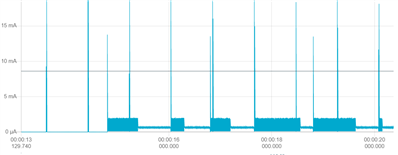

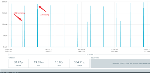

    Below is the current curve from PPK2 when only one channel is sampled, advertising interval is about 800ms. Every 2 seconds, SAADC is enabled, after sampling, SAADC is disabled. It works fine.
    Current curve from PPK2 when two channels are sampled.

    I have discussed this with some colleagues, and it sounds similar to an issue we've heard of earlier, where the High Frequency CLK is never released and thus is left running. This corresponds well with the 600 µA increase in current you report.
    Could you try to call TASKS_STOP at the end of your NRFX_SAADC_EVT_DONE event handling?
    Alternatively, could you check whether the status of the HFCLK is Running when the increase in current consumption is present?
    I will test your example here on my end shortly, to see if I can see the same behavior. If I am able to reproduce this I will open an internal ticket with our developers, so that they may examine this more closely.

  • Hi Roy,
    Please find the attached source code, tested with a nRF52840DK,  it works ok now with low power on multi  ADC channels.
    1: apply the errata 212 which helped. More details on this errata: https://infocenter.nordicsemi.com/topic/errata_nRF52840_Rev2/ERR/nRF52840/Rev2/latest/anomaly_840_212.html
    • As the source code re-configure the ADC on each timeout. So it’s ok to apply this workaround.
    2: change this  to 1 to use the workaround, 0: not to use.
        #define ENABLE_ERRATA_212_WORKAROUND  1
