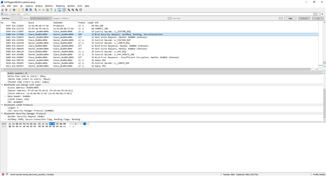

  • Here is the log. The perephrials address is ce:d1:0e:8b:17:66
    The exact steps performed were:
    1. Peripheral was erased using nrfjprog --ereaseall
    2. Peripheral was flashed with firmware and power cycled
    3. Made sure the peripheral was not listed under "previously connected devices" in android
    4. Rebooted the phone
    5. After the phone is rebooted turn OFF and then turn ON Bluetooth on the phone (may not be required, but it appears the bug happens more reliably with this step)
    6. Installed the android application from scratch and made sure its data was erased
    7. On-boarded the peripheral - it was on-boarded successfully
    8. Turned OFF the peripheral, it was disconnected from the phone
    9. Rebooted the phone while the peripheral was still turned OFF
    Expected Result: peripheral should still be bonded
    Actual Result: peripheral was not bonded
    1. Does the problem also occur if you disconnect and reconnect the peripheral before step 6?
    When turning off/on the Bluetooth on the phone between steps 7 and 8 above:
    Sometimes the peripheral disappears immediately, that is without a rebootbugtriggnorpa.pcapng
    Sometimes the peripheral remains, and in those cases it remained after steps 8 and 9 were performed (peripheral turned off/ phone rebooted)
    When the phone is rebooted without turning off/on bluetooth between steps 7 and 8, it seems the peripheral always disappears.

  • Yeah, I noticed after posting.
    Here are the correct files:
    The file named triggered is when the bug happened, notTriggered is the same procedure (except maybe not with step 5 above) but the bug did not happen, peripheral remained after reboot of the phone
    Edit: looking at the logs it seems the setup of encryption fails for some reason, it is worth noting that I did not see a disconnect on the peripheral side before pulling power.
    NOTtriggered.pcapng triggered.pcapng
  • Here is a third log where encryption seemingly succeed, but the bug was still triggered. Unfortunately it seems that the sniffer failed to capture the encryption keys. And despite several more runs the sniffer failed each time
    I've also added a fourth log, it is an bt snoop log from android from a run where the bug was triggered. If I'm reading it correctly, then encryption succeed in that case.
    Please let me know if there is anything else you need in order to be able to help us solve this bug.
    firstTriggeredButEncrypted.pcapng

  • The reason we are not able to decrypt the connection is due to LE secure connection is used (with diffie-hellman), unfortunately such connection can't be decrypted.
    However, I can find that the slave send a security request upon re-connection here, ref:
    This means (or at least suggests) that if the nRF52 is the peripheral device, then this FW have not followed the:
    "I have been working on this problem in a different case, I want to find out if your issue is related. To confirm please comment out the line bt_conn_set_security() that is found in bt_gatt_connected() in gatt.c and repeat your setup. Please do this test first."
    Can you double check with your collegues what may be calling bt_conn_set_security() here in the project, if not done by the bt_gatt_connected() in gatt.c?
