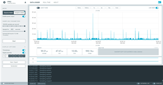

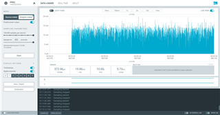

How do I reduce power consumption on the UART interface
In one of my projects, UART interface is used for the communication of external sensors. During the power consumption test, I found that when 9160 enters the idle state, its average current is about 600uA.  However, after I turn off UART, the average current in Idle state is only less than 100uA. Therefore, what method can be used to reduce the power consumption of UART?  So it goes to sleep after the data has been transmitted or it shuts down automatically or something like that?
this is my prj.conf file:
