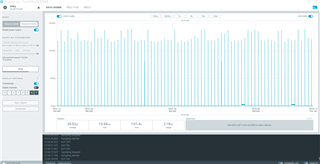

When power profiling I see occasional high sleep current of ~215uA compared to ~22uA expected. I tried to attached the exported PPK2 power profiler output to this report but the upload tool refuses to upload it (it's ~7MB)
Here's some screenshots to let you see what I mean. 1 minute chart. The tall spikes are the SPI reads every 800ms.

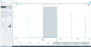

Here's a zoom in. As you can see the sleep current is sometimes quite high. (~215uA)

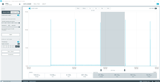

And sometimes much lower ~21uA

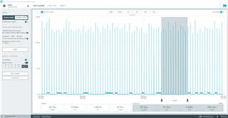

  • I've noticed it was a bit random whether it was high or low so I suspected it was related to the final bit being received from the accelerometer.
    If I add a completely unnecessary call to write a byte of zeros to an otherwise unused register on the accelerometer (Z_OFS_USR) then I get almost consistently low sleep current
    If I read the WHO_AM_I register then I get high sleep current 100% of the time
    Also, if I unplug the accelerometer from the PPK2 and give it power separately then I see consistently low sleep current.
    So at the moment, I think this is not nrf52 related. It's the accelerometer somehow.
  • PPK2 Logic port to the rescue again!
    Every time MOSI is left LOW, there's high current in the accelerometer. The AIS2DW12 has an internal pull up which I cannot disable.
    This code fixes it
      nrf_drv_spi_uninit(&m_spi);
      nrf_gpio_pin_set(SPI_MOSI_PIN);
