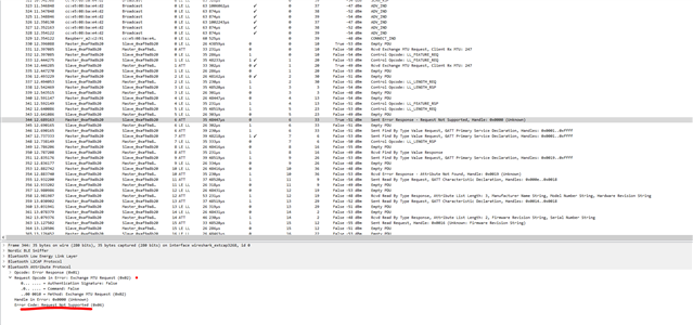

Enabling Data Packet length extension
Here is my configuration:
NRF52840
S140
#define NRF_SDH_BLE_GATT_MAX_MTU_SIZE 247
I would like to enable DDLE in order to get more than 27 bytes in each transfer
On both slave and master , I saw that the DLE is activated (LL_FEATURE_REQ and LL_FEATURE_RSP)
Also, in LL_LENGTH_RSP and LL_LENGTH_REQ, RX octet =251 and TX octet=251
With that configuration, i have :
The data to be sent is 112 bytes.
Could you help to understand why the data is sent in packet of 22 byrtes?
I added the wireshark log (with nordic sniffer).
3884.log.pcapng
Thanks for your help.
