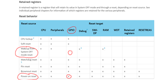

It usually works well. But time to time after wake-up from sleep mode, sensor data read wired.
In below picture, from -800 to -400, same value is read although sensor is shaken.
After power reset at -400, sensor data is read well again.
I checked sensor configuration with sensor company. They confirmed that it looks fine and suggest me to check difference between wake-up from sleep and power reset.
In 18.8 Reset behavior, It specified that GPIO and SWJ-DP, WDT, Retained register, RESETREAS isn't reset.
