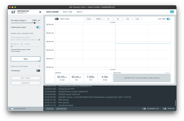

First, the PPK shows the current as large as 82mA. And I used the DK to do BLE connection. I suppose that the current should vary when the DK is doing different actions, like advertising connection, IDLE etc.
This is what I get. I previously get that current values when idle, but it still cannot have different current values when DK does different actions.
Now I just cannot get these more reasonable results.

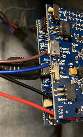

The following pictures are how I prepared for current measurements. I follow instructions and think I did correctly.

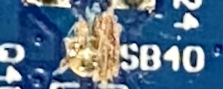

1. cut soldering bridge of SB40
2. put DUT and Power select to DK

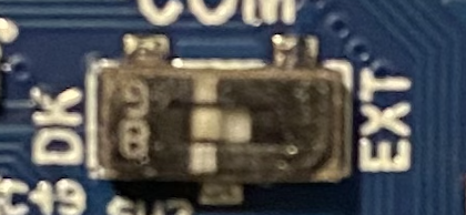

3. COM to DK
The values are weird.
