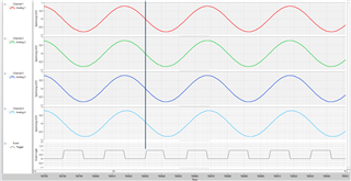

Project Description
in our project we have multiple nRF52DK and one nRF52840DK. We are using the SAADC on the nRF52DK. The SAADC is configured with 4 inputs in differential mode. The sample rate is 1 kHz (1 ms) and the resolution is 10 Bit. The samples get transmitted to the nRF52840DK via NUS. The nRF52840DK prints the received values into the virtual COM port over USB for further processing on the PC.
Test Scenario
A few days ago we tested this setup. We used a function generator and applied a 1.6 V_pp Sinuswave with a frequency of 20 Hz to all 4 differential inputs of the SAADC. So we expected to get identical results for all four inputs/channels of the SAADC.
Test Results
The picture below show the results of this test. The event/trigger signal at the bottom of the graph is not relevant. As you can see, the SAADC channels/inputs 1, 2 and 3 are equal and fine. When you take a look to channel 4 you can see that this channel 4 has a constant 1 ms delay compared to channel 1,2 and 3. The black vertical marker shows this well.
This is not the result what we expected.
SAADC configuration
The following code snippets show how the SAADC is configured and used:

Please let me know if you need any further information.
Own Findings
When I use defined values (which I increase every 1 second for example) for the adc_value_ch variables:
adc_value_ch1 = defined_value + TRANSMISSION_OFFSET;
adc_value_ch2 = defined_value + TRANSMISSION_OFFSET;
adc_value_ch3 = defined_value + TRANSMISSION_OFFSET;
adc_value_ch4 = defined_value + TRANSMISSION_OFFSET;
instead of:
        adc_value_ch1 = p_event->data.done.p_buffer[0] + TRANSMISSION_OFFSET;
        adc_value_ch2 = p_event->data.done.p_buffer[1] + TRANSMISSION_OFFSET;
        adc_value_ch3 = p_event->data.done.p_buffer[2] + TRANSMISSION_OFFSET;
        adc_value_ch4 = p_event->data.done.p_buffer[3] + TRANSMISSION_OFFSET;
the 1 ms offset of the channel 4 is gone. Maybe there is an issue when collection the samples from the buffer when calling "p_event->data.done.p_buffer[...]".
Questions
1. Do you have any idea what could cause this behaviour?
2. Is there a systematic error in using the SAADC?
3. Can you provide us some help, how to solve this issue?
Thank you very much in advance.
Michael
  • Hi Michael
    It's a bit hard to say what is happening here. My initial thought was that the buffer setup was incorrect and that the ADC would write to the buffer one position off, so that an old sample is left for one of the channels, but just by looking at your code I can't spot any errors.
    If I understand your code correctly you will get interrupts from the ADC driver every 1ms, which could be problematic if there are a lot of other interrupts in the system, but if this was the case I would expect to see more drastic errors than the one you are seeing. In general I would recommend increasing the size of the buffers in order to reduce the CPU overhead, as long as you can accept a bit higher latency.
    Have you tried disabling the handover of ADC data to the UART and the NUS service to see if the problem still remains?
    You should be able to check the values using the debugger in the case where you don't send the ADC data anywhere.
    Best regards
    Torbjørn
