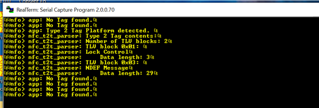

2.) Using the project "as-is" I am able to get some basic information about the tag that is being scanned.

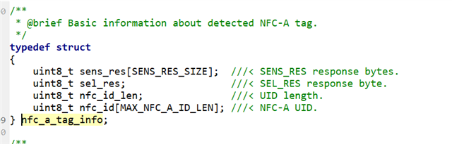

3.)  There is a structure that is used in the program the contains this basic information on the tag.
4.) What I would like to do next is to pull those 29 bytes of data from the tag and would like to get a recommendation on the approach.

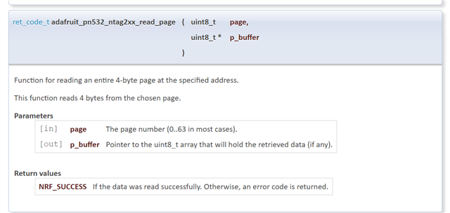

Or should I use the Adafruit PN532 NFC Shield library:
https://infocenter.nordicsemi.com/index.jsp?topic=%2Fcom.nordic.infocenter.sdk5.v11.0.0%2Fgroup__nrf__external__adafruit__pn532.html
Maybe I should use the function adafruit_pn532-ntag2xx_read_page ? Where should this be placed in the sequence of everything?
