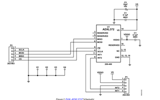

ADXL372 I2C Unable to Communicate i2c_nrfx_twim: Error 195952641
I am trying to run the NCS Zephyr ADXL372 sensor sample application (using nRF5340 DK) but get the following error:
Could not get ADXL372 device
[00:00:00.000,518] [1B][1;31m<err> i2c_nrfx_twim: Error 195952641 occurred for message 0[1B][0m
This corresponds to the following NACK error:
NRFX_ERROR_DRV_TWI_ERR_ANACK    = (NRFX_ERROR_DRIVERS_BASE_NUM + 1), ///< TWI error: Address not acknowledged.
I have stepped through debugging and see that it is unable to communicate with the ADXL372 using the NCS/Zephyr driver. Basically the ADXL372 driver fails its init/probe routine because it cannot read from the ADXL372. I cannot figure out why this is failing to read, I will attach my project files and zephyr.dts build files below. I have a feeling it is either an error in my overlay config or my wiring.
Project Files:

Hardware/test-bench setup:
So I am using the ADXL372Z (EVALUATION BOARD / MODEL) to be specific. From what I can tell there is no difference between this and the ADXL372 besides packaging.
This is the schematic/pinout provided for the ADXL372Z:
These are my notes on I2C wiring and how the ADXL372 is wired to my 5340dk (referencing above schematic):
ADXL Pin | Logic | 5340DK Pin
P2 MOSI	 = 	SDA  = 	P0.09 (4.7k Ohm pull-up to VDD)
P2 CS 	 = 	SCL	 = 	P0.10 (4.7k Ohm pull-up to VDD)
P1 INT1  = 	INT	 = 	P0.11
P2 SCLK  = 	GND	 = 	GND
P2 MISO  = 	GND	 = 	VDD	  (pulled low I2C address = 0x1D, pulled high I2C address = 0x53)
P2 GND   = 	GND  = 	GND
P1 GND 	 = 	GND  = 	GND
P1 VS 	 = 	VDD  = 	VDD
P1 VIO   = 	VDD  = 	VDD
Any help would be appreciated. I will add that I wasn't able to get it working using SPI the other day either but I don't really care about SPI so not too important.
