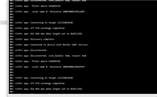

BLE APP UART central using NRF52840 eval kit and Fanstel BWG840 gateway gets disconnected using a 0x8 error code while trying to receive data from a peripheral
 NRF52840 eval kit is configured as ble_app_uart_central and for peripheral, we are using movesense sensor which is running our firmware. The central and peripheral get connected without issues. When I send commands for streaming data from the peripheral, we get a message saying disconnected and then reconnection happens between the 2. The central side was tested using NRF52840 eval kit as well as using Fanstel BWG840 gateway and the same behavior is present in both scenarios. The peripheral works as expected with the android application. It would be great if anyone can help us in identifying the reason for this behavior. Our plan is to have 20 movesense devices connected to the Fanstel BWG840 gateway and sending data.

  • Thanks for the support.
    Found the issue. It was a minor mistake on my central side code.
    switch (p_event->evt_type)
    /**@snippet [Handling data from UART] */
    case APP_UART_DATA_READY:
    index++;
    (index >= (m_ble_nus_max_data_len)))
    do
    ret_val = ble_nus_c_string_send(&m_ble_nus_c, data_array, (index));
    if ( (ret_val != NRF_ERROR_INVALID_STATE) && (ret_val != NRF_ERROR_RESOURCES) )
    APP_ERROR_CHECK(ret_val);
    } while (ret_val == NRF_ERROR_RESOURCES);
    index = 0;
    While playing around with code, I was sending data of size( index-1 ) instead of index.
    With index-1 disconnection is present and with size set as index there is no problem
