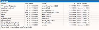

    the UART example you mentioned is for BlueTooth module and it use NUS service. I wonder if the "printk" function in gps example also uses NUS service? Is there any conflict if I initialized the same UART port with printk?
  • The Peripheral UART application demonstrates the usage of the Zephyr UART library. You have to pick the UART snippets you would like to use and implement/modify them towards your GPS application.
