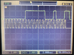

I would like to create SPI clock timings using the following documents.
https://infocenter.nordicsemi.com/index.jsp?topic=%2Fps_nrf52840%2Fspim.html&anchor=topic
1. CSN pin moves from High -> Low
2. Data Set
3. Data recognition when clock data is moved high
The setup values are as follows.
SCNPOL = 1
CPOL = 0
CPHA = 0
The waveform (example) I want to operate is as follows.
But I have this problem.
When the clock goes up, the data goes up at the same time.
The source code is as follows.
