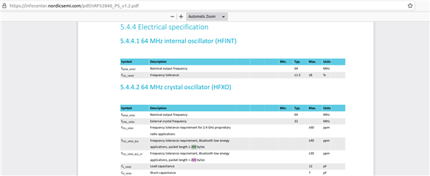

What layer of BLE stack datasheet mentions in Crystal tolerance section?
NRF52840 datasheet section "5.4.4.2 64 MHz crystal oscillator (HFXO)" mentions crystal tolerances being dependent on packet size.
It is not clear to me, what layer of BLE protocol it refers to: L2CAP? ATT?
We're using BLE ATT to exchange rather long packets (very often over 200 bytes), with ATT_MTU set to smaller values ( experimenting in the range of 32-180).
Could someone please confirm (better officially), that those 200 bytes mentioned in datasheet relate to ATT_MTU (L2CAP layer), not ATT one?
