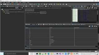

I have a custom board, I am using to evaluate nrF52811 from eclipse (I just prefer this over SES).
I have installed S112 on the flash and also my application at 0x19000 built using this liker script

INCLUDE "E:/Library/Nordic/nRF5SDK1702d674dde/modules/nrfx/mdk/nrf_common.ld"
However, while debugging with openocd, I realized my main method was never called but rather the firmware is faulting from within S112 firmware at address 0x189cc even before main is called
