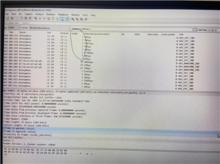

i am able to run this example and see the advertising on my ios. But when i am tracing it using nrf sniffer app i am not able to find it...what is the issue
also i want to have AUX_ADV_IND PDU packet how will i get it?
pls tell what is length here
The nRF Sniffer does not support extended advertising, so you cannot use it in this case. It is better to test with a recent phone (that supported advertising extensions), as described in this post.
