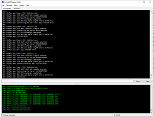

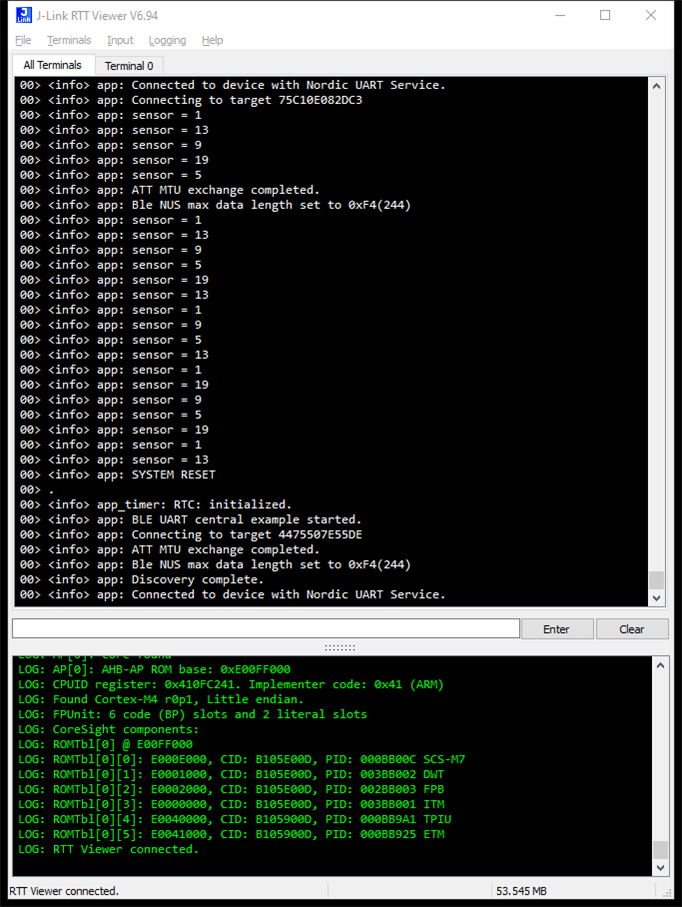

  • Hi Einar, I understood what you said in your poster. Which parameter should be modified to make more peripherals? I changed the APP_ADV_INTERVAL from 64(default) to 600 and the peripherals can add up to 15. But the central board will reset every 6 or 7 seconds after the change even the number of peripherals increase. The debug information of the central board is shown below.
    Which parameter else should I change to stop the reset?
