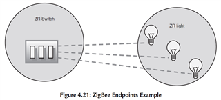

Imagine that I want to have a device that measures for instance two temperatures at two different locations (Inside/Outside a fridge). How can I report these two temperatures? I learned that each application can have a set of clusters, but can I have duplicated clusters in the same application? If so, how can I do that?
The cluster that I want to use is the temperature measurement (0x0402).

  • Hi Fernando,
    As it was pointed above one solution for this would be to have multiple endpoints in your device. Endpoints allow for separate control points to exist within each node. I have seend this implemented with On/Off cluster before, for instance having a switch device and a lightbulb device, each with multiple endpoints to have separately controllable lights in one device, and three separate toggle switches in another device, for example:
    Figure taken from the Zigbee Wireless Networking by Drew Gislason.
    One endpoint for each of your temperature sensor will give you more flexibility to control each sensor and configure attribute reporting in my opinion.
