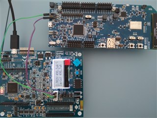

I have nRF9160 DK:
  • PCA10090 v0.8.3
  • modem firmware 1.2.3

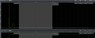

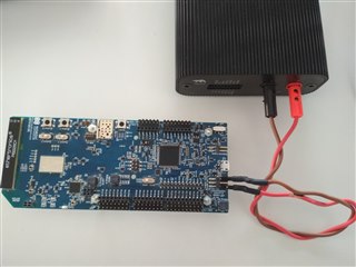

The specifications says that the minimum consumption current is 7µA. So I flash a hex file  which shuts down the modem and puts the chip to system OFF mode which I find it here and I measure consumption with STM32 Nucleo expansion board and it was ~500μA.

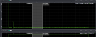

Also, I tried a very simple program
main.c
#include <zephyr.h>
void main()
	k_cpu_idle();
 prj.conf
CONFIG_SERIAL=n
CONFIG_AT_HOST_LIBRARY=n
CONFIG_STDOUT_CONSOLE=n
CONFIG_LOG=n
and
spm.conf
CONFIG_IS_SPM=y
CONFIG_FW_INFO=y
CONFIG_GPIO=n
CONFIG_SERIAL=n
nrf9160dk_nrf9160.overlay , nrf9160dk_nrf9160ns.overlay
&adc{
	status ="disabled";
&i2c1{
	status ="disabled";
&uart1{
	status ="disabled";
&i2c2{
	status ="disabled";
&uart2{
	status ="disabled";
&spi1{
	status ="disabled";
&spi2{
	status ="disabled";
&spi3{
	status ="disabled";
&uart0{
	status ="disabled";
but still current was ~500μA.
I tested older modem firmware as 1.1.0,1.1.1 and 1.2.0 also current ~500μA.
any suggestions?
