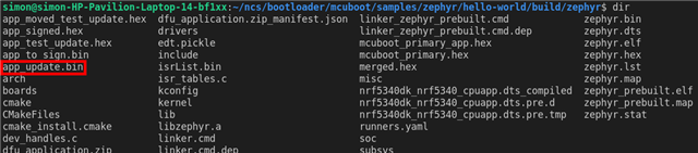

  • You don't need to sign the image yourself. Simply add CONFIG_BOOTLOADER_MCUBOOT=y (will add mcuboot as a child image to the sample) to the prj.conf file of the sample <ncs location>/zephyr/samples/hello_world and a signed version of the .bin file should be located in <ncs location>/zephyr/samples/hello_world/build/zephyr/app_update.bin.
    Check out https://developer.nordicsemi.com/nRF_Connect_SDK/doc/1.5.1/mcuboot/readme-ncs.html for more information.

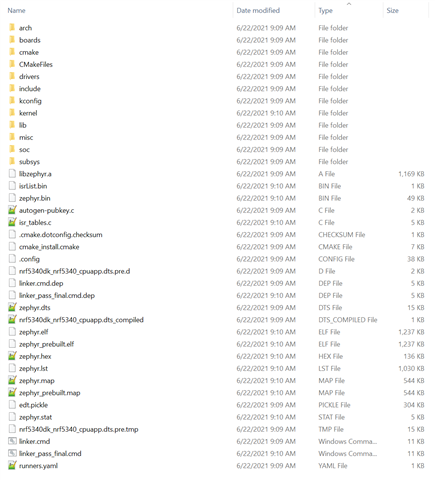

  • Hi Simon,
    I have CONFIG_BOOTLOADER_MCUBOOT=y in the hello world prj.conf, but I don't see any app_update.bin file generated. The only two bin files I see are the normal output, in this case it is named zephyr.bin, and the isrList.bin.
    Below is the original prj.conf for hello world:

    From the documentation, only CONFIG_BOOTLOADER_MCUBOOT=y should be needed to get a signed image.
    Thoughts?
    Thanks in advance.

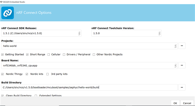

  • What version of NCS are you using? I just tested this with NCS v1.5.0 opened through the Toolchain Manager:
    • To get the hello-world, I clicked on the three dots left of the "Projects" field and chose C:\Users\<user name>\ncs\v1.5.0\bootloader\mcuboot\samples\zephyr\hello-world
    • Notice that I change the build name to "build" instead of "build_nrf5340dk_nrf5340_cpuapp" due to Windows Path length issues
    • I also checked "Clean Build Directory"

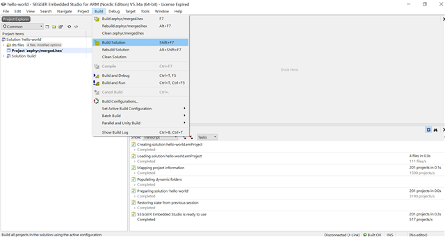

    • Then I clicked on "Build Solution"

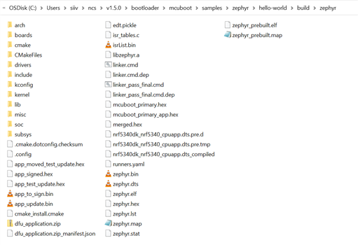

    These files were then generated, including "app_update.bin"
    Can you follow the exact same steps and see if you get the same result?

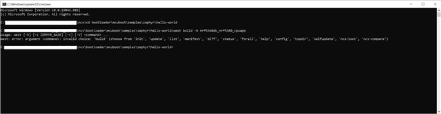

    uhrm said:
    We use SES to build our applications. We don't use West so I'm not too familiar with it; still I tried but it is not recognizing the 'build' argument, see below:
     Check out 1.3.2 Build and flash to see how to build using west
    Simon
  • Hi Simon,
    I use NCS v1.5.1. So, I moved ncs to make the overall path shorter, and also shortened the build folder as you did. Followed the same steps than you and now I get the signed files! There seems to be a strong dependency on the path length though.
    Anyway, I will keep an eye on this, but for now seems to work. Thanks for the help.
