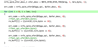

I am trying to read data from a chip over SPI.

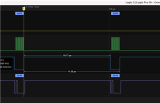

The implementation of the SPI comms is not ideal as they require a new CS/SS line toggle on every byte.  I cannot do a bulk SPI read.
I am seeing a 10uS delay between each SPI XFER.  Is there a way to speed this up?  This is greatly increasing the read time.
Here is my SPI setup.  I am using SPI3 to allow for hardware SS line control.

Here is my read loop, I have to read each byte out individually.
    You could setup and trigger the SPIM manually, which will omit all the pointer checks and so forth:
    nrf_spim_tx_buffer_set(spi.p_reg, &reg, 1);
    nrf_spim_rx_buffer_set(spi.p_reg, &rx, 1);
    nrf_spim_event_clear(spi.p_reg, NRF_SPIM_EVENT_END);
    nrf_spim_task_trigger(spi.p_reg, NRF_SPIM_TASK_START);
    while (!nrf_spim_event_check(spi.p_reg, NRF_SPIM_EVENT_END));
    This should speed things up.
