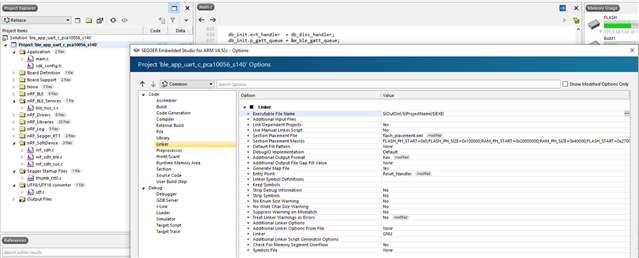

  • I tried this and I get the error: "cannot find run section .cli_sorted_cmd_ptrs_run referenced in cli_sorted_cmd_ptrs"

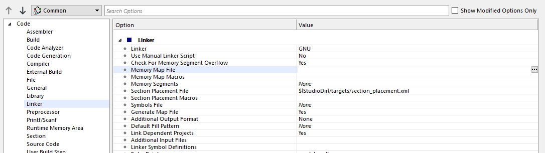

    I have seen this is a common issue in other threads and that sometimes the memory segment in the project must be updated though I could not find with what it should be updated. Here is what mine currently looks like. Thank you.
  • That does not look correct. You are missing section placement macros as well. It should look something more like this:
