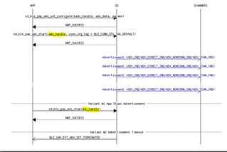

    err_code = sd_ble_gap_adv_stop(m_conn_handle); // WHAT PARAMETERS TO PASS HERE????
    if (err_code != NRF_SUCCESS) {sprintf(outputString,">>ble adv stop failed\r\n");SEGGER_RTT_WriteString(0,outputString);}
    You are supposed to pass the same advertising handle that was used when you called sd_ble_gap_adv_start() as this message sequence chart shows:
    (sd_ble_gap_adv_stop)
    But it's also ok to pass '0' here.  The current Softdevices do not support multiple advertising handles.
    Vidar
