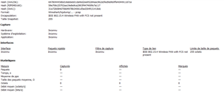

I also specified the parameters of the API function that starts the capture process, then I run the script and generate the pcap file well.
The problem is that the pcap file is empty, but when I launch the Wireshark capture software, it captures the network data.

    Would you like to share your python script so I can test it on my side? It may be easier for me to debug having the code available.
    Are you using pynrfjprog to start the connection to the DK? If so the connection must be started before capturing pcaps. You should then create and channel set:
    from nrf802154_sniffer import nrf802154Sniffer
    self._sniffer_api = Nrf802154Sniffer()
    self._sniffer_api.channel = self.channel
    //and to start capture:
    self._sniffer_api.extcap_capture(self.pcap_result_file, self.com_port, self.channel, metadata)
    Marjeris
    First of all, I would like to thank you for your answer and for your help,
    I did the same thing as you finally I managed to capture and generate the pcap file, but the problem is I wanted to make a script that allows me to capture the data live and display them in the console.
