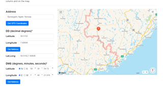

    [01:00:18.274,536] <dbg> agps.supl_logger: MCC location info injected, MCC: 240
    [01:00:18.284,545] <dbg> agps.supl_logger: Lat: 5851520 Lon: 780606
    [01:00:18.293,548] <dbg> agps.supl_logger: Unc semiminor/semimajor: 119/119
    [01:00:18.303,222] <dbg> agps.supl_logger: Unc altitude: 127
    [01:00:18.311,614] <dbg> agps.supl_logger: Confidence: 100
