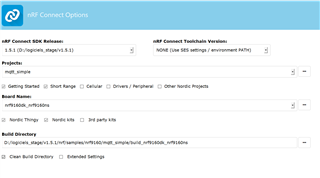

I'm trying to run the MQTT simple sample, i don't know why but i can't build and run the project and also i cannot connect J-link.
Do you have any idea?
Thank you in advance !

My pleasure, Léo! :-) I’m a little bit curious about the root cause, though. Would you mind sharing it with me?
Thanks and regards,
Markus
Yes, it's just because I forgot to open the project with Nrf connect sdk project and all the options like this :
Léo
