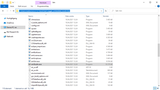

I'm trying to run the MQTT simple sample, i don't know why but i can't build and run the project and also i cannot connect J-link.
Do you have any idea?
Thank you in advance !

How did you install the nRF Connect SDK? Via the Toolchain Manager or manually?
I’m a little surprised about the path of your Segger Embedded Studio though, because an installation via the Toolchain Manager will install SES within the NCS folder, as shown in the picture below.

It's okay, i find the reason of the problem,
thank you Markus!
My pleasure, Léo! :-) I’m a little bit curious about the root cause, though. Would you mind sharing it with me?
Thanks and regards,
Markus
Yes, it's just because I forgot to open the project with Nrf connect sdk project and all the options like this :
