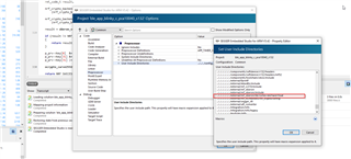

hello,
you mean this one?
if yes, then, it is already there...
No, I was not thinking of the include directories. Here the linker is complaining so it is the actual binary that is missing. That should be added simmilarly to how you add a c file. See here:
...ouch...that hurt, thank you very much!!! it is now solved.
